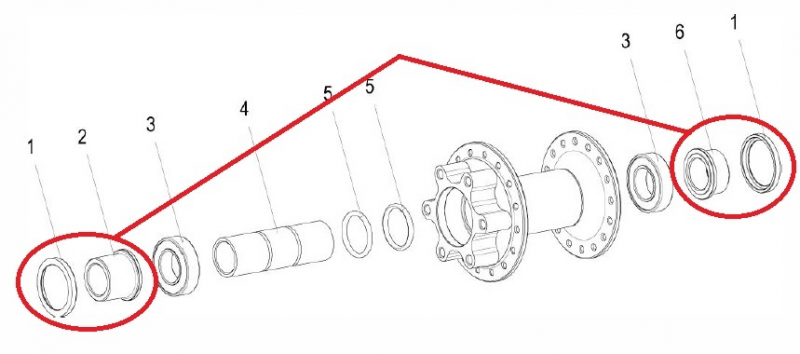

Can you go "in" from the other side with a long punch or drift and wack it?
This. There is an aluminum spacer (#4) in between the two bearings that can be pushed aside from the inside. Get a drift or punch and work your way around to knock out one side. You can then easily do the same to the other bearing or use a press. Not sure if picture this is the same hub but should be pretty similar in design.

Gotta support the hub shell when you are punching it out. The force required goes from 11 to 1.
If there's rust, that's a different story.
I've "reassembled" cartridges that exploded just to remove them before. Food for thought.
plus 2 #4 is pushed to the side.
