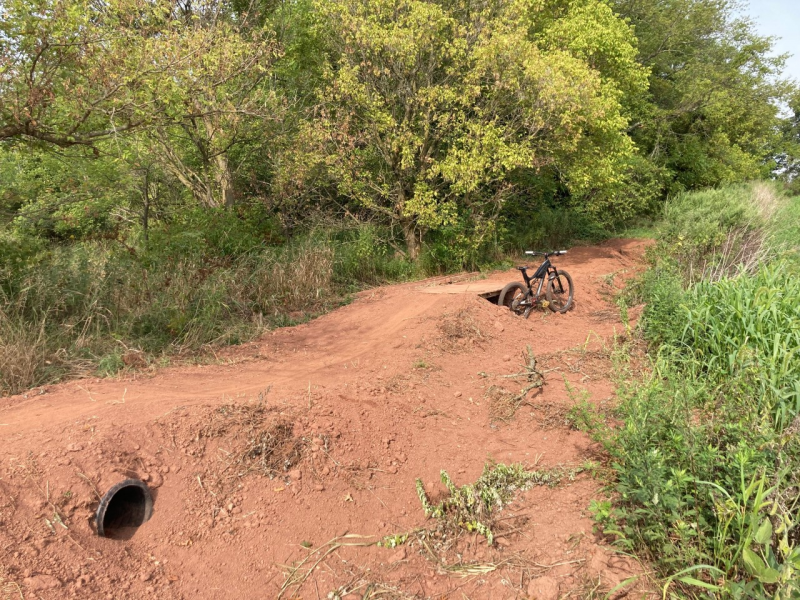

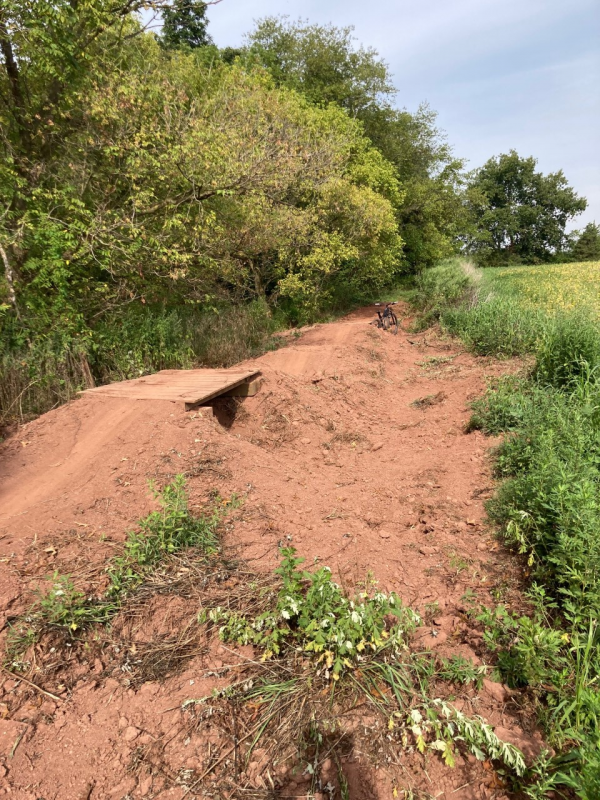

They are now 43" between rails, 45" between posts. That was as far as i could go without bridge surgery.
Temp patch on the bridge deck - ran out of wood, and forgot to bring the charged batteries with me.
Not to mention I was already 7 hours into the day.
maybe if you make it wide enough, you won't need to make rails
Absolutely, there is a standard for that. See below.
