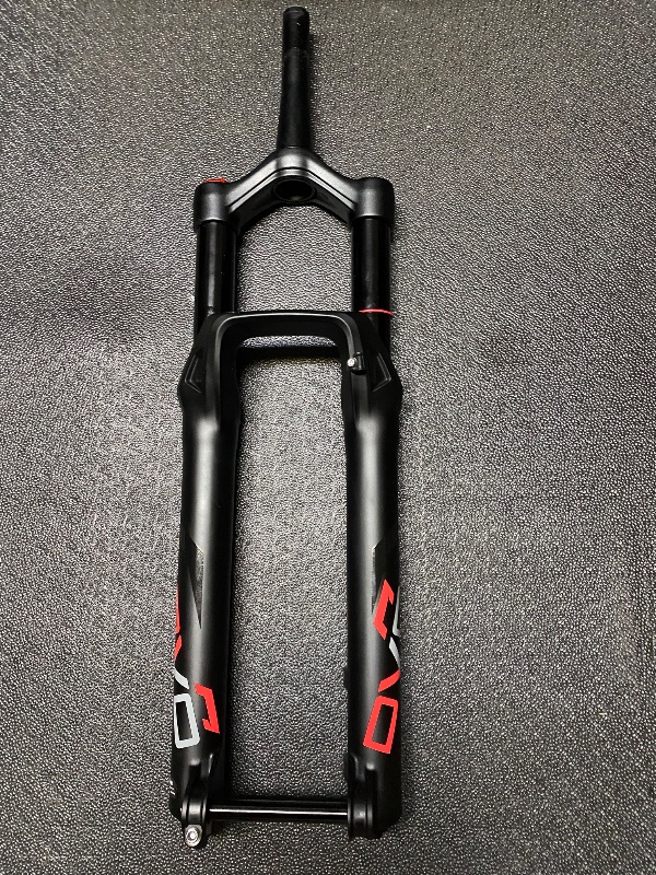

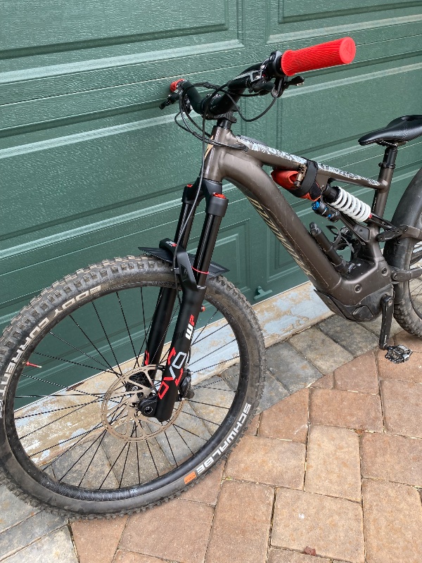

The DVO 38 WP is pretty awesome on my Kenevo

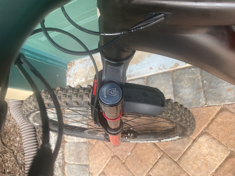

I have a smash pot in an a1 Zeb with a 3.1 damper. Definitely works well with small bumps. I am pretty sure it binds up on bigger hits because the a1 lowers have smaller bushings than the a2 lowers with the bleeders. Just like a regular Zeb ultimate with an air spring, you would have to huck off you roof to flat to use all the travel. The DVO is the best fork I have ridden.

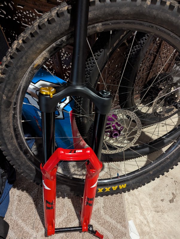

You can get a z1 coil for $350, and then pickup a grips,grip x2 or MRP damper for less than $450.
A stock bomber z1 will be more than capable For your needs. As a lighter rider who is pretty smooth i usually prefer the cheaper dampers over the over priced dampers with multiple adjustments.
FYI, per 2025 z1 coil has a grip damper, 2025 going forward has the rail damper( bit of a down grade). If the goal in park riding, good damping cuts down on “arm pump”.
