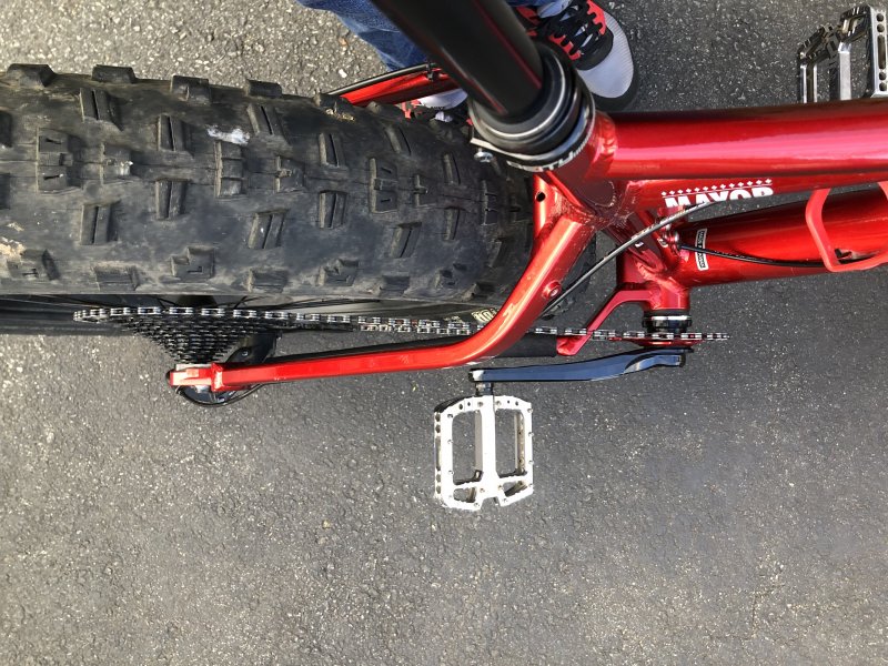

bergsnj
I just cleaned and lubed the chain and that basically solved the noise issue. But I may still get a 6mm offset ring to bring the chain line closer to the inside. I have a lot of clearance. When in the 50t:

one piece crank
If you take your existing chainring off, you can lay it on a flat surface and measure your current offset.
For the new ring, go for Absolute Black oval.

is that direct mount?
isn't there a spacer system for that?
bergsnj
It is the race face cinch direct mount.I want to keep the crank spaced the way it is for pedal arm clearance with the chainstays. I'm going to give a 6mm offset absolute black oval ring a try.
serviceguy
RF only makes 3mm offset chainring as of now. Both Wolftooth and OneUp have their proprietary system that deal with different offsets using a dedicated spider.
Not sure what the offset offering from other manufacturers is.
I spent more time than it would be considered sane researching this crap when I built my Mukluk, mostly unnecessarily as I ended up using standard RF component and it has been fine ever since. OneUp seemed unofficially confirm that their switch standard (non boost) setup would be best (they led me to write that myself in my e-mail but did not confirm not deny that was the intended use).
I guess tighter tolerances with a boost chainring makes the chain noisier when in not perfectly clean conditions?
Steve Vai
AbsoluteBLACK or Wolftooth 6mm is the move. You can also run an 11-speed spacer behind the cassette to move that out.
