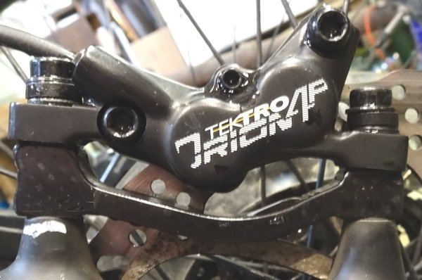

Hey Pete, might help if we saw how many washers are stacked between the brake caliper and the mount. Like someone else said, you probably just have to remove a few small washers to get that caliper to sit a bit lower. Once you get that caliper to sit a bit lower you should take the pads and file that ridge down so that that rotor meets a uniform surface on the pad.

no washers here. I have a plan, file down the block about 2mm.
I don't think so, it's never been off since new, maybe I could flip it now and see how that works
i think i changed my mind. but probably worth playing with? Gotta take it off anyway
or it is just the wrong one.
For giggles I removed the front caliper which is the same and never been off the bike either.

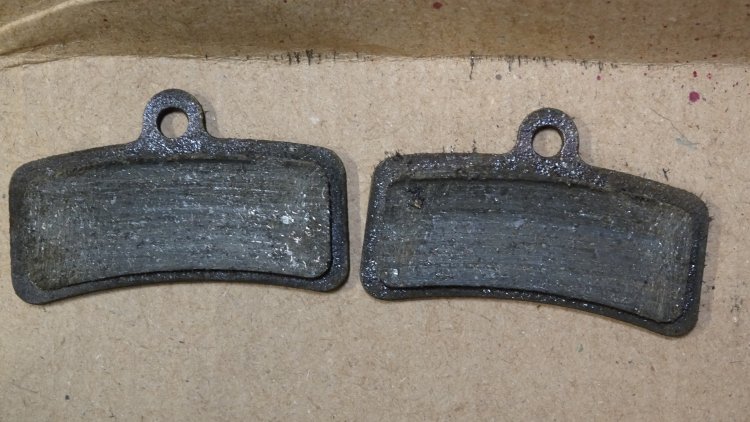

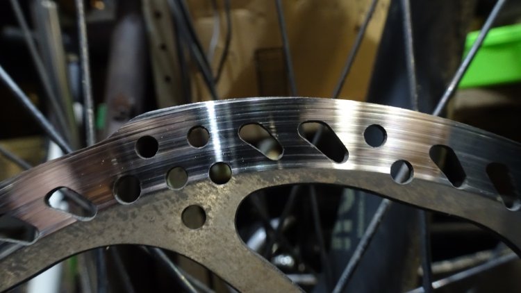

It's the same condition there. Here are photos of pads and rotor.

see ridge upper edge
again
see rotor, no ware on lower section
Weird. It’s close but the design tolerances should guarantee the braking surface of the rotor to overlap the pads top and bottom.
The caliper definitely needs to move towards the axle based on your pad and rotor wear. I’d flip the bracket before you start filing; it may be just enough to get you there.
At this point you prolly need a new rotor too. I believe you have had this issue since new.

id also look into sticky pistons, that brake pad on the left doesnt look evenly worn down.
