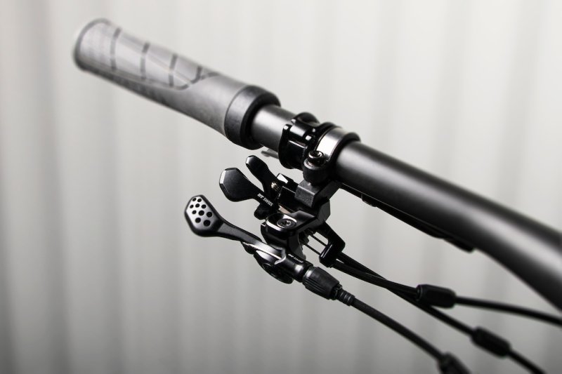

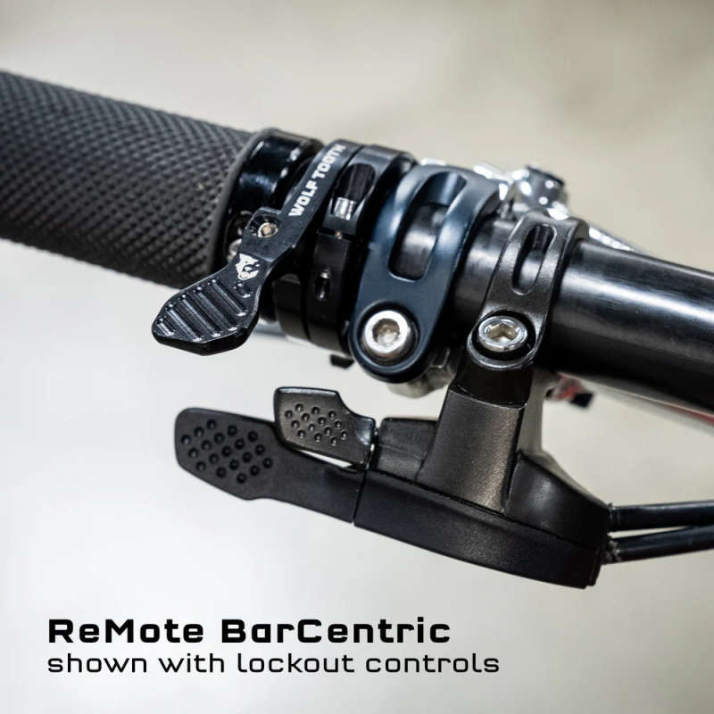

If you use something like this to actuate the dropper you could free up the real estate where your current dropper lever resides for a new lockout.

I run the suspension lockout in on the bar out of the way of the dropper lever. Like 2 inches inward. Hardly ever ride the bike locked and it’s the same where no cable = locked. The better way is to run the gripshift lockout on the left and then the dropper remote has no interference.
