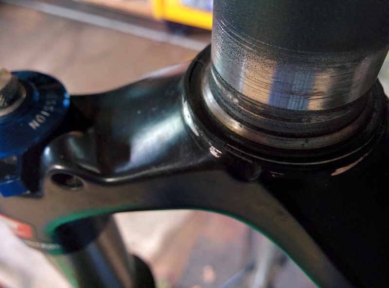

Found an MY08 Reba for sale but the steerer tube looks pretty beat up. Is this going to cause any issues?
i'm guessing something got into the head tube and made those marks. or there was some rust, and they thought it better to clean it up.
you'll need to remove that race to install the one that is made for your headset. Like porkchop mentioned, as long as it doesn't spin, and is square, you are good to go..
Is it me, or does the second photo look like some material has been worn away??? I would have a bike mechanic give either the yeah, or nay on this. IMHO that could become a weak point.
Can't see it from here, but @Frank is right. There appear to be grooves worn into the crown race sleeve, which, while not structural, does not speak well for how the fork was treated (bent steerer?).
I would pass on it
a failed steerer during a ride sounds horrible regardless on how great a deal you're getting
