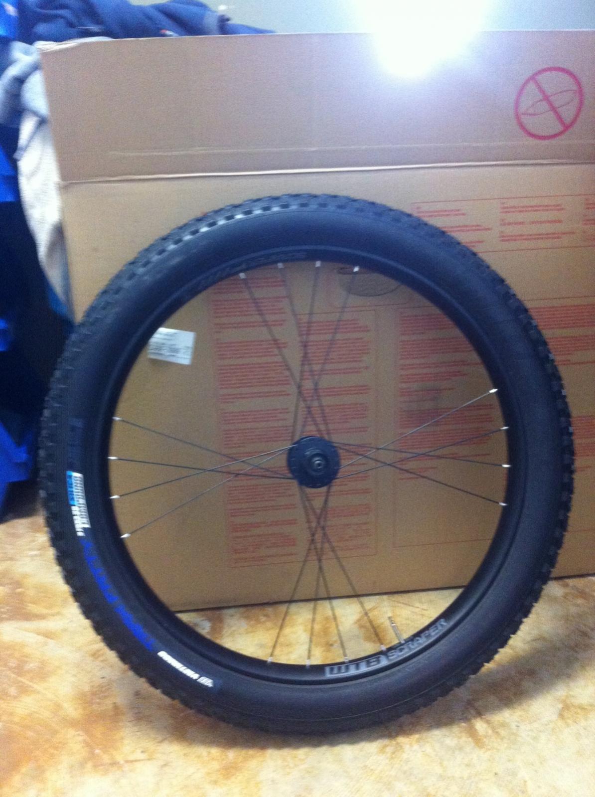

Today my new rims and hubs arrive. I'm building up a second set of wheels for my Farley Fat bike. I decided to see how a 27.5+ will work out and how close the diameter is to the standard 26x4. I'm using the WTB Scraper TCS rims and I'm gonna start with the VEE Rubber TRAX Fatty 3.25 tire(not many options yet, and the wtb tires coming don't seem wide enough for my application). This is more of a project for spring/summer, as I am looking to hit the ole race circuit again on the fat bike. I think this combo has the potential to take about another 2 lbs off my bike and make it feel a little more nimble in the trails. Don't get me wrong, its very capable as it is, but I can't leave things alone. Stay tuned for updates.

if you're really curious.... I'll let you know when tires come in and we can through a couple spokes in a hub and mount the tire to the rim to see if it clears your frame. Let me know, sooner than later, cuz I could just get antsy and start building em up. Tires are still a week out
Matty, you may be a better candidate for the wtb 2.8 tires, or even a 2.5 with wider rim, but we can always see what fits

so... the rims and hubs are here, but tire eta got pushed back another week from the distributors.
as for the rims, claimed weight is inaccurate. The website claims 406 grams while several other sites claim 650 grams. Well, one weighed 640 and one weighed 650. I'm happy with that. Tubeless will be a breeze too.
Matty, I'll let you know when tires show up so we can see about clearance

they came in! I already laced one up to a 135 qr rear hub. Matty come on in and see if it fits.
FYI, tires weigh 940grams
