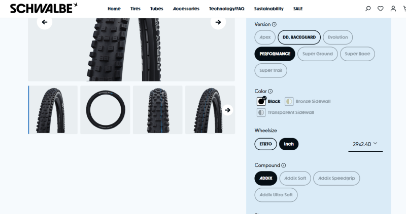

I understand there compounds and casings, but my question is regarding the “performance” line and the question is basic, Do they suck?
For maxxis riders, is this line the equivilant to the “dual compound, exo/tr” tires. I.e., their plain ass tire?
i believe performance is a legacy compound/casing which is no longer manufactured, so you either sat on the tire for a while or bought a NOS tire that was on sale, IIRC it was their standard option and they had options which increased performance from there.
My only experience with the performance line of tires was on new bikes, so now that i think about it like that it could also be their OEM sales line, either way its not the best of their offerings.

They very well might be mainly OEM, however you can buy it aftermarket DTC:

I've run a ton of Schwalbe over the years, in both the old and new compounds. The old compound tires wore fast for sure, especially for my multi-surface rides. I mostly ran Racing Ralphs in that version, and a few runs of Nobby Nics. With the new addix stuff I've run RR in the new and old tread pattern (didn't like the new), Racing Ray, NN, Magic Mary Hans Dampf and probably a few I'm forgetting. The new compounds wear considerably better, especially in the side knobs, with no noticeable loss of traction compared to pre-addix.
They use "performance" in two different descriptions - quality and version, and it's confusing af to decifer. As long as the compound is the addix versions I like, I'm not super concerned. That screenshot you posted supports your theory of incorrect online photos, since they're blue lined, which means addix speedgrip, but yet listed as normal addix, which should probably read addix speed (the only one missing from the 4), and that's a red stripe.
