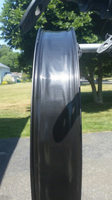

Those mulefuts setup great with 2.88" gorilla tape btw. If they have the really wide rim strip, I'd cut it down a bit for more tape adhesion to the rim. For this particular set my buddy wanted green so I used 2 wraps of green duct tape as the rim strip.
Thanks @C8N!! Can't download any pics, it says files are too large.
@sk1er18, that's the same set up I'm going with, already purchased the green duct tape. Did you start/stop the gorilla tape at the rim bead?
You want to get the tape as far as possible onto the bead so the tire sits on it.
The seam you see in my picture is the second layer overlapping the first wrap. One wrap for each bead.
