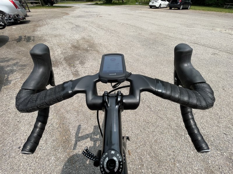

First ride on the new build, pieced together with 2nd hand/on-sale parts. Doubt I'll ever bikepack tho.
