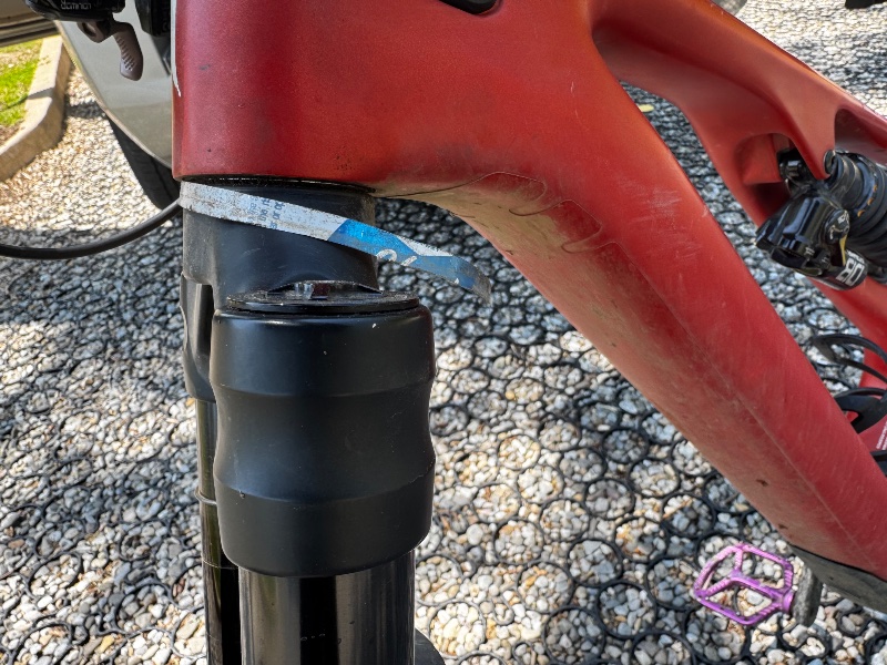

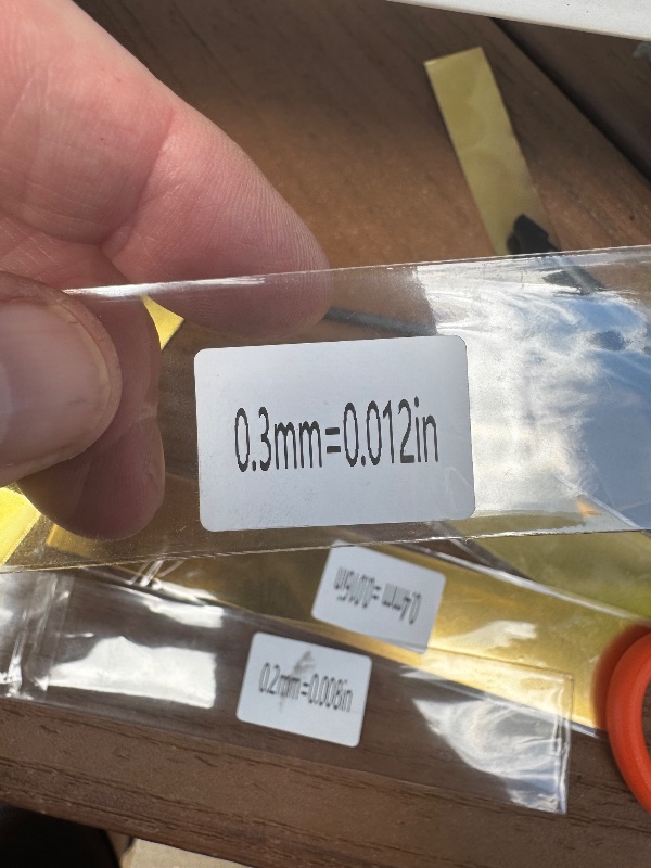

Noticed my Kane Head High headset shim stopped working. Replaced with actual brass shim stock to see if it will last longer.
View attachment 281401View attachment 281402View attachment 281403
What's being shimmed? Headset cup for a better bearing fit? You might have better luck sizing the shim "properly" (ie, no overlap), joining the ends with a torch, and installing it with green loctite. Once cured, run a headset reamer through it. If you size the shim up, you can make a perfect fit with the reamer--it won't mind munching through slightly-too-much brass.
The headset reaming tools for oversized bearings aren't common, but some shops do have them.
BTW, beer can shims can work fine, just make sure you soak them in acetone to remove the plastic liner that all modern cans have.
Even if you don't ream it, it can be a good idea to make a solid ring shim, as installing a shim on a cylindrical surface like that when it is split can be an exercise in frustration.
It's actually a shim between the headset cup and the carbon frame. The fit is rediculously loose.
