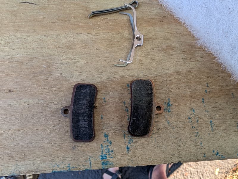

I have more data, I scrubbed the rotors, brake kleen, then copious amounts of rubbing alcohol, The pads are metal pads, they seemed glazed, and cleaned up with sandpaper, brakekleen, and then lots of rubbing alcohol, I rebedded the pads, and the bike is definitely stopping better, but I think either 200 or 203 fronts with MTX pads are in my future!
To reiterate what others said, better pads and not only larger diameter 200mm rotors, but also try to find thicker rotors for increased heat dissapation. Stock shimano rotors will be 1.8mm thick but you can get 1.95-2.0mm rotors from Galfer, Magura, Hayes and Sram. You'll need to fully bottom your pistons, drain a little brake fluid from the ressy and get the centering just right but they can fit.
New as in picked up august, under 100 miles on the bike. I spent a bit of time talking to The Lost Co, and have adapters, 200 mm sram hs2 rotors (2mm) and MTX gold pads on route. I am thinking it should be better, there was no leaks around the pistons.
