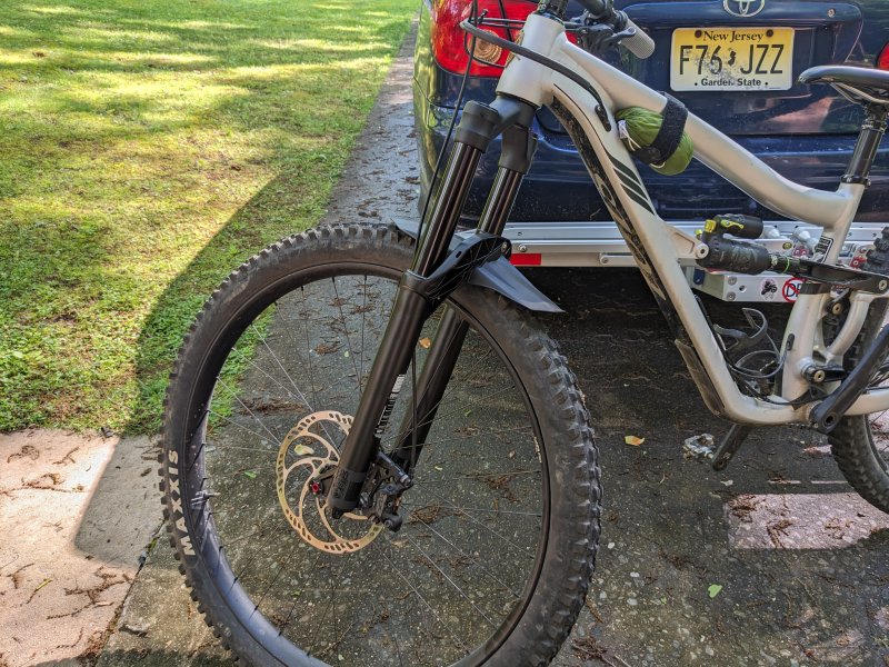

10 cent o-ring was sticking in my old fork so I bought a new one.
Damnit, I installed it backwards. I'll see how it rides that way anyway.

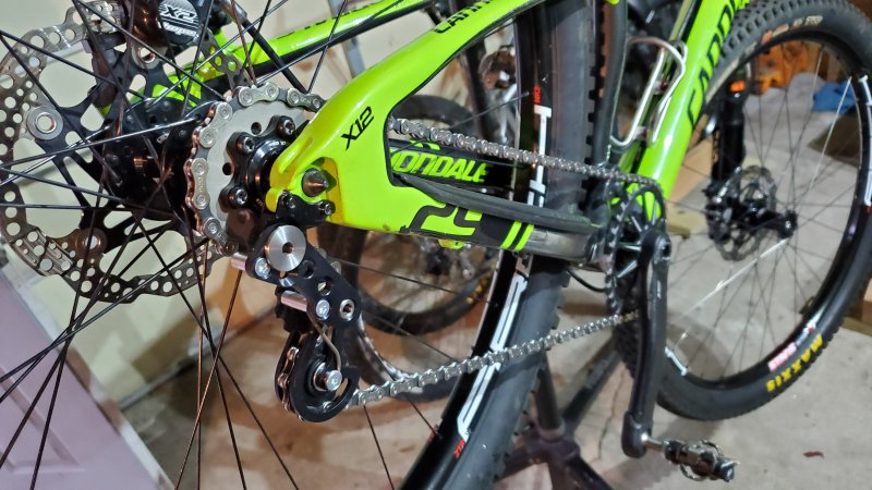

Was exploring a switch of my TSE 5 day reg from 50+ to SS. Have a '16 Scalpel that doesn't get used much. I ride mostly rigid SS but that would be painful over 5 days in Central PA. The Scalpel has full lockout, a dropper and XD rear hub. Discovered that even though all info I found online said a 20t works with a Rohloff tensioner, the Zinger cog and upper jockey wheel were always in contact. Switched it to the 18t and all is good. Not switching my reg, but will ride it around home area.
Throwing more $$ at the "problem" but the Paul Components Melvin chain tensioner is rated for 20T. Similar two-pulley setup.
I just thought of this, and not sure if ANOTHER component is simplifying anything but you can try something like a Wolftooth Roadlink.
Thanks. As the plan was only to have a solution available to SS any of my geared bikes, went with the Rohloff vs Paul's based on 20t compatibility and price. Have also seen some Goatlink mentions on mtbr. The Roadlink looks like the better option.
