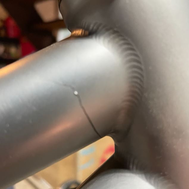

For the past few weeks, I've had a creak coming from my bike that I was trying to solve - it only happened when I'd stand out of the saddle so I couldn't really mimic the torque enough in the stand to locate the source at home. So I went through the usual suspects - cleaned out and tightened the bottom bracket, swapped out the pedals (which actually did seem to quiet things a bit, although now I realize that was probably just a coincidence), etc. But after I got home yesterday, I went to clean off the dust and grime from RC and noticed this ...
A crack around one of the downtube bottle bosses (the ones for bike packing mounts on the underside of the tube.)
Seriously??? It's a Moots! Moots NEVER crack. In fact, when I called the shop about it, he told me that in all his years of selling Moots, this is the first time anyone has EVER had one crack. (And I believe him because Moots does offer a lifetime warranty on their frames, so they are replacing it.) But it's about halfway through the tube. I actually consider myself kind of lucky that I found this while at home and it didn't reveal itself on the 50 mph descent down White Oak Road at the end of the ride yesterday.
So, in what passes for good news in 2020, I now know what was causing that creaking sound.

A week ago, I took a four day weekend to go camp out at Raystown and just ride with nothing else getting in the way. My plan was solid - get to Raystown Friday before noon, set up camp and then ride it all. Then Saturday, gravel ride in Rothrock. (I've already been out to State College for an MTB ride this summer, and I'd been wanting to do a gravel ride there ever since noticing just how many such options there are.) After that, I'd play it by ear to see how I felt about riding Raystown again on Sunday morning before heading home. So Friday and Saturday pretty much went exactly according to plan - I was originally consideirng riding form Raystown to the southern most portion of Rothrock along the Eastern Divide Trail, but decided against it because it would have involved a lot of navigation through backroads and I decided to just keep it mellow. I'm glad I did, too, because it's actually quite tricky to follow those road sections laid out on the bikepacking.com course there - not terrible, but considering my goal to keep things enjoyable, more stress than I would want for my first real vacation bike trip in a few years. Perhaps another time. Camping was great - especially Saturday night" I got back to Raystown around 5:00 and then hiked down to the boatr launch area and enjoyed a really cool sunset. So I wake up Sunday, feel pretty good and decided to start early and get another 30 or so in before heading home. So I ride out on the western section and then head over to the eastern. And then, as I'm cruising along Grippis Trail toward Ray's Revenge, out of nowhere I hear the sound I know all too well - the kind of grinding metal sound that can only be one thing ... I stop mid-trail and start to examine my bike and sure enough, there it is ...
No idea what caused this. I'd have understood if this started back on the rock garden near where Alley and Gripppis meet. But where it started on Grippis is one of the smoothest sections of trails in the whole park. This was just plain failure.
So my ride ended there. I walked out of the trails and just packed up and left. I was drerading the conversation with my shop on Monday because I was pretty sure I had a much bigger problem this time around - Moots no longer makes the Mooto-X. I'm obviously still under warranty since this frame is only a year and a half old, but if they don't even make them anymore, what good is that? So anticipating a potential shit show, I reached out to one of apparently very few companies offering a SS specific frame that doesn't require an EBB (Vassago) and inquired when they'd have restock on their Optimus Ti frames in small. They got back to me right away and that's great - I put one on reserve and intend to get that regardless of what happens with Moots. But Monday comes around and I'm still on my mini vacation, so I bring my bike over first thing when Evolution opens and Scott thinks I'm kidding when I tell him I have another cracked frame (because to this day, in the 30 years he's been selling Moots he's only hada two instances of frame cracks - mine in 2020 and ... mine in 2022.) But he sees it and reaches out to Moots and his contact tells him to send it back (I had already emailed them the pics above by then) and they'll see what they can do. So as of now, the plan is to try to remove the top tube and replace it - meaning they will remove any trace of the existing welds and weld in a new top tube since they cannot replace the whole frame. Will it work? I don't know. They're assessing it now. If not, I don't know what my options will be with them but at least I'll have the Vassago on order. Yay bikes ...

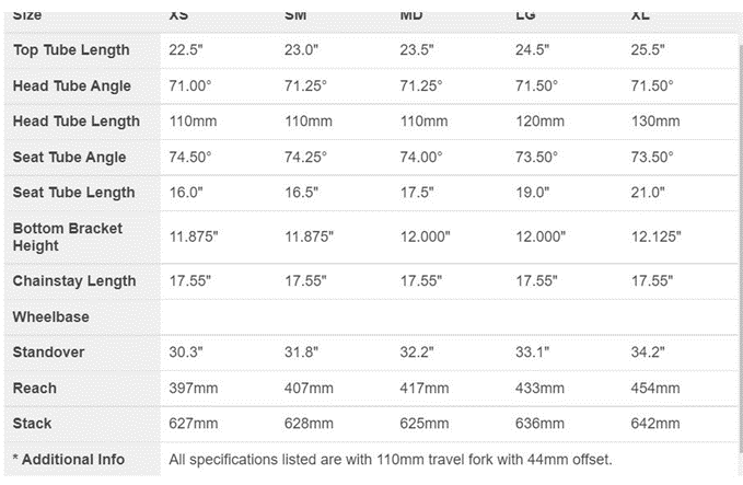

What are the geo specs of the Moots? The current Optimus Ti shows a 67.5 HA with a 120 fork. A 100 fork would just steepen it a bit, which might make it closer to what you're used to?
Also, the website specs show a 30.9 seat post. The older model Vassagos used a 27.2, but I think they moved away from that size awhile ago - at least for their mtn bikes. Even the steel VerHauen has changed to a 31.6 post vs. the 27.2 mine had some years ago. Likely due to everyone wanting internal dropper post routing, which has very limited options in 27.2.
The head angle is 71.25. That's a fair difference - what I'm more concerned about with putting a "non-optimal" fork on is the "net difference" in feel. It's already got a longer top tube , longer reach and stack, etc. to accomodate the slacker angle, so I just don't know if the overall feel of the bike will be comparable no matter what I do, you know what I mean? Like, yeah, I could mimic a steeper angle with less travel, but now the top tube and reach is forcing me forward more because of it, unless I start cascading everything to try to jerry-rig the fit. My gut is telling me two things here - one, these differences aren't huge, but, two, I'm really picky and weird with how I want my bike to feel. So those two are kind of in contention now. Aaaah ... I'll figure it out before they have new ones in stock I guess.
At any rate, thanks @JDurk for making me aware of this - it's one of those things that woul dhave bugged me in a huge way if I ignored it until the frame arrived.
Moots:
Vassago:
Moots:
Vassago:
