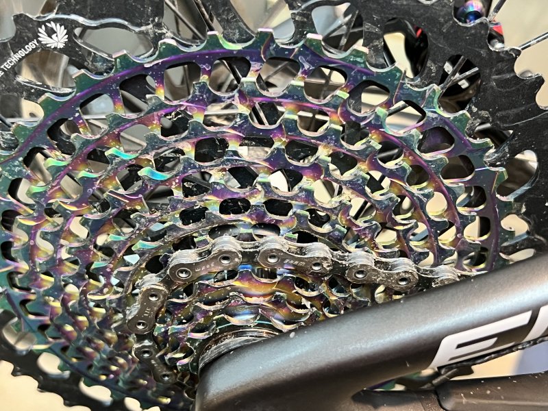

This is about how dirty a properly waxed chain gets. Completely silent and saving watts.
I am trying nixfrixshun new green genie wax based lube. It is impressive so far and just drip-on.
I listened to another podcast with a guy who does wear and efficiency testing on chains.
You need to strip the brand new chain completely of the stock grease. (It’s terrible).
Then apply the wax and let it dry. They said the silca stuff was the best by far, but I don’t think that NFS was part of the test.
I geeked out and now that I’ve done it a few times, it’s amazing. A little more work but I never thought I’d be able to tell a difference. I can. And no mess chains are awesome.
