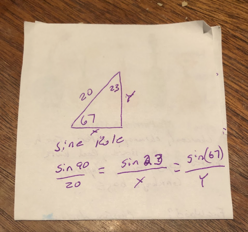

My bad, was actually a 12mm spacer. But still, moving stem back 4mm or more changes bar over axle position.If i did a quick calculation - a 20mm spacer with a 67deg headtube angle will move the bars towards the seat 7.8mm.
sin(90)=1
x=20 x sin(23) = 7.8
the rise is 18
IDK, I am not going to try and math it out like @Patrick but it always felt better on the mtb the closer you can get to being slammed with the stem and run a riser bar. Especially for things like cornering. Mind you we are ignoring sweep and rise that riser bars typically have compared to the average flat bar.Changing a spacer is exactly the same as swapping to a riser. Your body will be in the same spot and have the same effect on handling.
NO.If i did a quick calculation - a 20mm spacer with a 67deg headtube angle will move the bars towards the seat 7.8mm.
sin(90)=1
the rise is 18

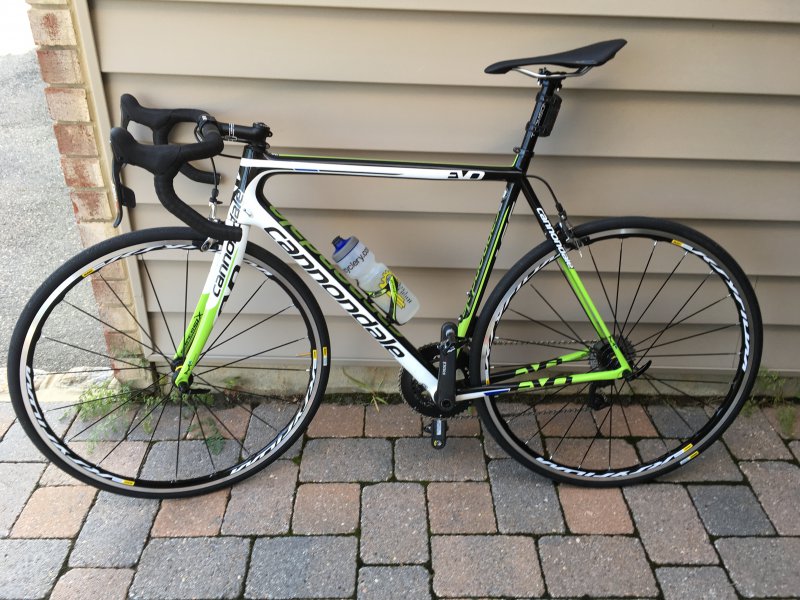

Briefly reviews Pat's EVO setupSo i'm rethinking "actual" vs "effective" -
reducing strain on your lower back (or reducing weight on the bars) means being more upright -
assuming your bars are below the pivot point of your body (there is not 1 pivot point)
moving straight up would decrease reach and bend angle, if it is above, it actually increases reach, but offset by reduction in angle. interesting.
it also messes with effective stem length (if that is a thing? virtual center of bars to center of steerer?)
so much for academic look - it probably isn't worth a dime until you try it out, and see what works. like those compliant bars that give a little
in the vertical.
Holy aero when in the drops.Briefly reviews Pat's EVO setup
That’s why my back was locking up every other week lol.Briefly reviews Pat's EVO setup
