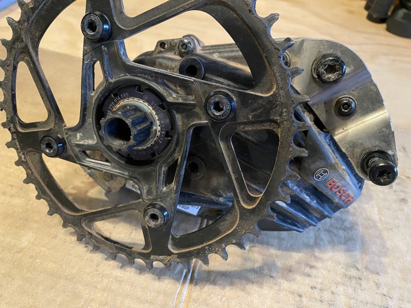

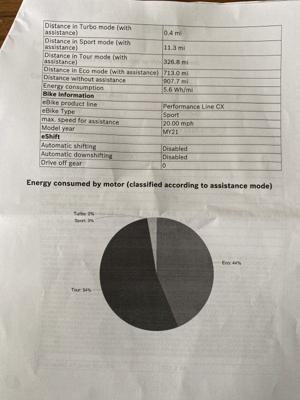

Tell me about it. I have a MY21/22 Canyon Grail-on gravel ebike. Supposed to assist to 28 mph but I was pretty sure assistance was cutting out at 20 mph. Canyon said I could take it to an authorized Bosch dealer to have max speed increased. My local Bosch dealer bike shop ran the motor diagnostic and said they could not increase the max speed because the motor is a Performance Line CX (max 20 mph) instead of a Performance Line Speed (max 28 mph). So, not the right motor even though it had a Performance Line Speed badge on it.
From the ride statistics in the diagnostics report, the motor has 1,959 miles on it. I'd keep it in Eco most of the time (lowest assist level) but report says I did 908 of those miles unassisted (so above 20 mph). I was working harder pushing an ebike every time I got over 20 mph, lol.
Anyway, Canyon did the right thing and sent me a new Performance Line Speed motor and reimbursed me for LBS labor to install.
Now I have a perfectly good Bosch Performance Line CX motor, if someone wants to give me 5 clams for it.
