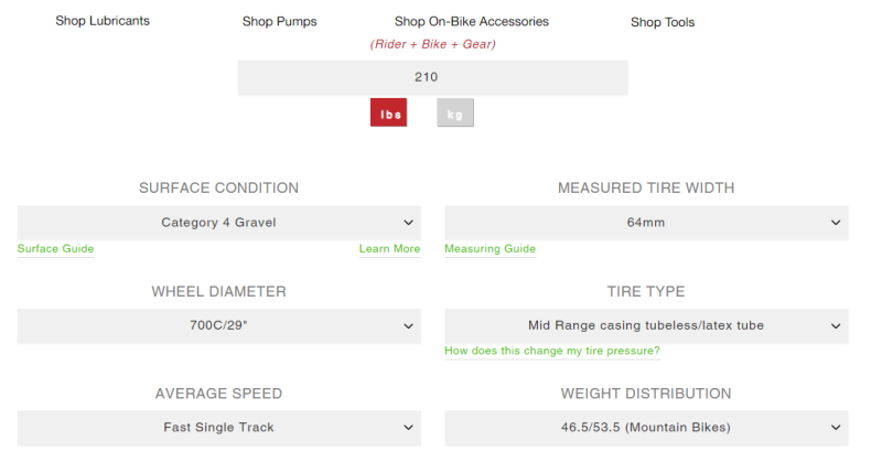

SILCA Professional Tire Pressure Calculator
Dial in your bikes' tire pressure to get the most comfort, speed, and efficiency on your ride. If you are looking for the best free marginal gain, click heresilca.cc

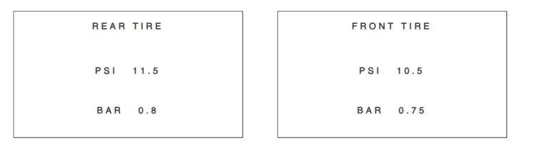

Edit: just put in some numbers, and it has me at 10.5psi front/11.5psi rear for my mtb. No way I'm riding my bike with those numbers.
