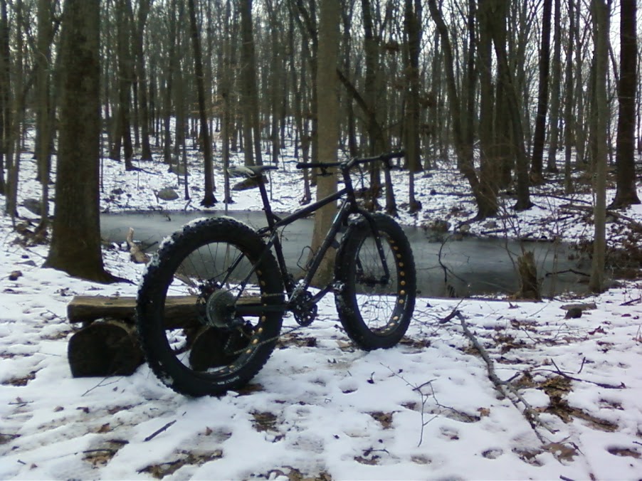

So I got the 2013 Necro Pug about 3 weeks ago and got 3 rides in so far. I like the bike a lot. Very fun to ride. Very different. Those friction shifters are different but got used to them after the 1st ride. I have no issue with them at all. I'm used to riding a SS so shifting is somewhat of an afterthought. I do think those types of shifters are easier to use when wearing bulky gloves in cold weather. I'm learning that setting the correct tire pressure has a huge impact on the ride. I bought one of those low pressure gauges to dial this in. That is a "must have", IMHO. My only complaint so far is the braking power. Bike comes with BB7's. I've used them in the past and thought they were fine but here the response just seems lacking. This may also be something I need to adapt to, perhaps after a few more rides.
Nice bike! Yep, ditto for the Muk. They got better after a few rides, but me thinks the front could use a 180 given the weight of the wheel/tire combo.
Could just be caliper adjustment. Or swap out those cheep FR-5 levers for some Speed Dials.
SD-7 levers online available for $20/pair. will a $20 upgrade really make a difference? that would be great.😀
Congrats on the ride!
I added the sd-7 levers, it does help dial in the system. More feel and I didn't even do it right just yet. But I'd agree with icebiker it needs a little more. Been shopping rotors myself and wouldn't complain if I ran across a deal on a nice set of hydros. But the bb7's are growing on me a bit.
First thing I did with my muk was purchase a set of elixir 5 brakes with 180mm rotors. Made a huge difference. The bb7 With the small rotors Definately did not have good stopping power needed for the huge wheels.
