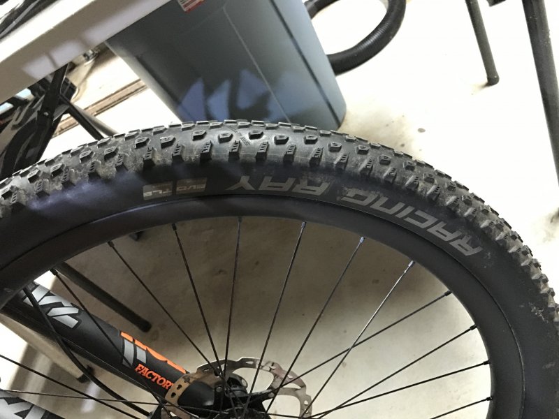

Can u snap a picture of the tire info? Just curious what it says.
* the section in the photo I added.
