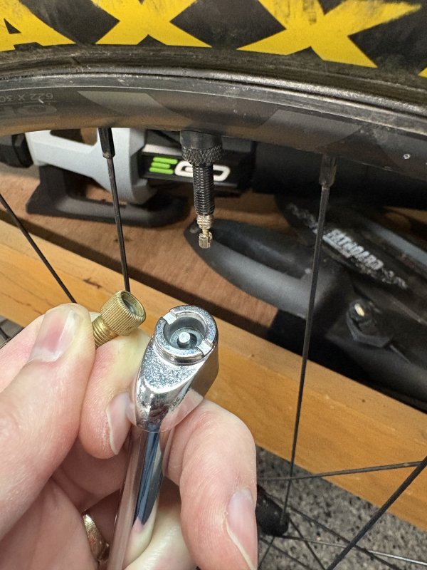

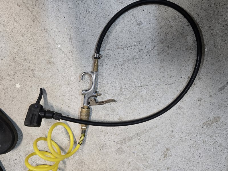

Did your compressor come with this?
If so, electric tape a rubber tube to the end like so…
Simply remove the valve core and blast away!
*Note: I didn’t remove the valve core. This is for demonstration purposes only. 😁

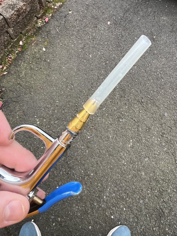

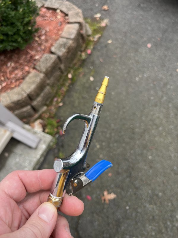

I essentially do the same thing but with one like this. No tape needed, just slide a piece of vinyl tubing (fish-tank air hose) over the end and over the valve stem with core removed and good to go.
