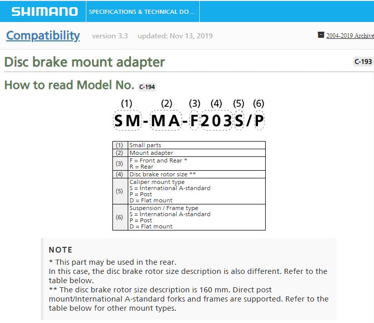

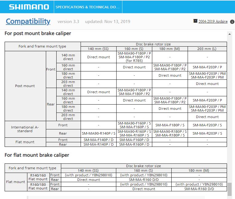

How do I know if I picked the right caliper mounts? fork and frame are 160 direct mount, for has a 203 max and the frame has a 185 max, just looking for more leverage to delay getting zees.
This confused me it just shows what's available but not when to use it
You’re right, that is just for the bolts. Let’s try this, what mounts do you have on the fork/ frame and what size disc are you going to use?
Frame and fork post are 160mm ? Some fork come with 180mm. Anyway, I found the correct charts at the link below (it has lots of usefull info, hoses compatibility, pads etc., just scroll down to the adapters and you'll see the two charts below.
https://productinfo.shimano.com/#/com/?q=BR-M8120&enter=1&cid=C-460&acid=C-461
