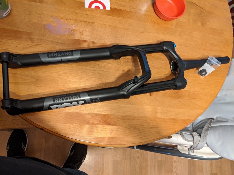

Alright here is the breakdown for the bike of price paid shipped and fees
Frame; NS Bikes Eccentric Alu EVO 29 Frame 2019; 222.10
Fork; Fox 34 Rhythm 29/27.5+ E-Bike 150 Grip 51mm Kabolt 110; 275
Wheel Set; Raceface Ar27 with Novatech hubs; 150
Freehub body; 11spd Freehub: Shim/Sram XS-Type; 46.99
Bottom Bracket; SHIMANO XT BB-MT800 BOTTOM BRACKET; 19.99
Shifter Cable Set; SHIMANO MTB STAINLESS SHIFT CABLE SET; 16.99
Headset; CANE CREEK 40 IS42/IS52 TAPERED HEADSET; 60.00
Front Rotor; Shimano RT66 6-Bolt Disc Brake Rotor 203mm, RT66L; 23.99
Rear Rotor; Shimano RT66 6-Bolt Disc Brake Rotor 180mm, RT66M; 19.49
Front Brake Adaptor; https://www.jensonusa.com/Shimano-F203PP-Disc-Brake-Adapter; 8.25
Rear Brake Adaptor; Shimano F180P/P2 Disc Brake Adaptor 180mm Rotor, 74mm Caliper, 74mm Fork; 6.99
Seat; WTB Koda Race 2019 Saddle Black/Red, 142mm; 20.98
Crankset; Shimano SLX Fc-M7000-B1 Boost Cranks 170mm, No Chainring; 79.99
Grips; Nukeproof Neutron Knurled Lock On Grip; 11.99
MISC
Brake Bleed Kit; SHIMANO TL-BT03 DISC BRAKE BLEED TOOL; 19.99
Brake Fluid; SHIMANO BRAKE FLUID - 1 LITER; 19.99
Bottom Bracket Tool; Foundation Shimano Style BB Tool Black; 9.99
Wish list
Dropper Post; Brand-X Ascend 120mm & 150mm Dropper Seatpost; 109.99
Seat Post Clamp; Nukeproof Horizon Seat Clamp
Tire; Maxxis Ardent MTB Tyre - EXO - TR; 40.24
Brakes; Shimano Zee M640 Disc Brakes - Front & Rear Set; 195.36
Recycle
SLX Cassette
SLX Chain
SLX Derailleur
SLX Chain
Deore Front and Rear Calipers and Levers
Handlebars
Pedals
Stem
This is all from memory I thought I'd start organizing myself to see what I'm missing and plan through spring and summer acquisitions. I hope to be able to acquire 27+ set for the winter but its low on the list after deciding a groupset(most likely box 9 speed or shimano slx 12 unsure still...)
Thanks to @serviceguy and @Paul H and who ever added their cents for their advice
Just catching up..... I didn’t notice a seat post, top cap, star nut & bolt or a crown race mentioned in your build. If you covered it elsewhere please ignore the response. The crown race and top cap stuff may have been included in the headset purchase, but they don’t always.. so I figured I’d mention it.
