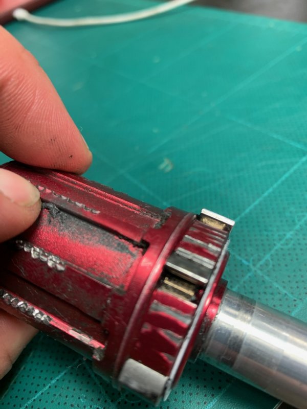

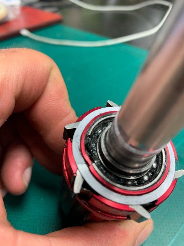

Serviced the rear hub--cleaned out old grease from the freehub mechanism, clean/reassemble, lube. Axle bearings okay, so I left them for the next round, but shot a bit of grease in the left side, since it looked a bit thin.

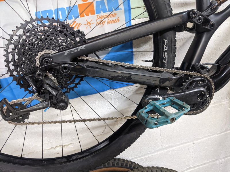

GX AXS kit #2 installed on the Chameleon. Also went on without a hitch, although I did have to open the manual again to remember how to pair the shifter to the derailleur. The B-screw needed more adjustment on the Chameleon than it did on the Megatower. Weight without pedals: 29 lbs. 13 oz. Helm 1 fork (130mm travel), Deore 170mm cranks, 12 spd XT cassette, Industry 9 Backcountry 450 27.5 wheels, Nobby Nic 2.8 tires, XT 4-piston brakes, Manitou Jack 150mm dropper post, Flite saddle, Pro Taper 35mm x 770 mm carbon bars, Pro Taper 50mm stem, Intense rib grips. Hopefully I can get it on dirt during the week. I'll get a picture when it stops raining...

Swapped the old 500% X01 derailleur for a new 520% X01. Even though it worked with the 52T cassette, the shifting was never crisp. I bent the hanger, which completely threw the derailleur off so it was time to upgrade.

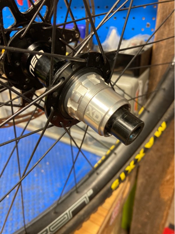

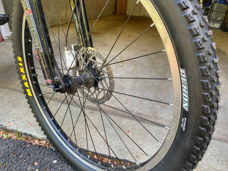

Bought a set of XC wheels built with DT 240 EXP hubs. Found out that the new EXP hubs have a recall for a slipping engagement issue. Sent rear wheel in for service and they comp'd me an upgrade to 54t ratchets free of charge! Downside was no bike for 2 weeks during prime spring weather.
Dealt with a too Enduro tire setup and a too xc setup on the other wheelset so I changed it up. Also finally got the 2nd cushcore installed.
