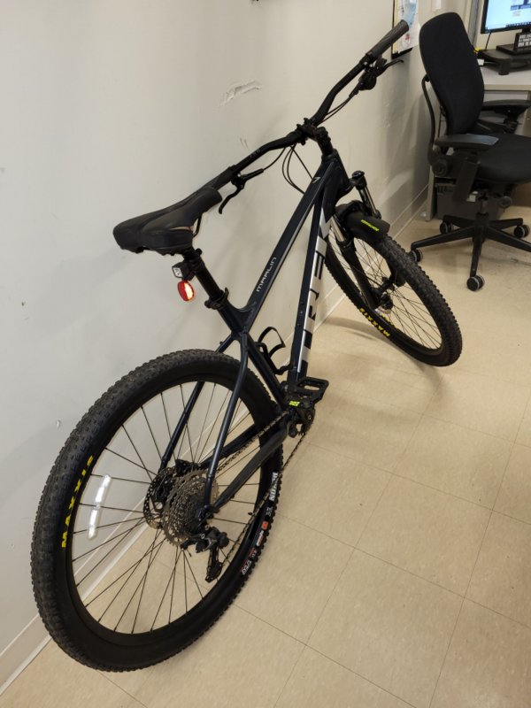

Just upgraded my 21 Trek Marlin7 wheels from stock tubed 29" to a wider tubless with rapid drive fast engagement 108 hub. Also upgraded from 29x2" wide Maxxis Ikons to Rekons in 2.25". HUGE bump in response/traction without any noticeable increase in rolling resistance. Running 26 psi makes all the difference on my build.
Also swapped in PNW RANGE BARS after cutting them down from 800 to 760mm. An external Dropper is next 🚲

Yep, you’ve definitely contracted upgrade-itis. No worries, you’re in a safe space…. You’ve found your people. 😁

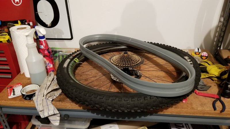

Cushcore install failure !!! I came home to a flat tire after the install, pumped it up and sprayed soapy water around the rim. Bubbles from spoke nipples and what looks like a seam in the carbon rim. Off to the bike shop we go, turns our the rim is fine, the tape was compromised. Took me just about as long to get the dam tire off the rim with the insert as it did to put it on, can't even imagine doing that on the trails. Did the tape over (first time) and put the tire back on without the insert. Success, holding air just fine. Now I'm on the fence about putting Cushcore back in, might let my LBS do it while I'm away in 2 weeks.

Roll&Tuck really makes all the difference. I was able to do an install real quick and I am no mechanic, I didn't even use the trash can. Then I blew the tire and had t do it all over again, but that's a different story

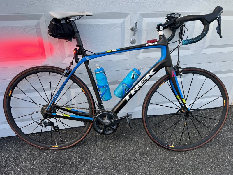

After months of riding with mismatched wheels I got my hands on these slightly older but barely used Mavic Kysirium Pro SL carbon wheels from a friend who gave me a screaming deal too good to pass up.
Lucky also found 2 sets of brake pads locally so I set everything up last night with new GP5000 dark wall tires. First test ride today for 50+ miles they roll nice and smooth and braking is excellent compared to my old Alu rims. They even make this cool turbo kind of sound when im braking. These weigh in at 1390 according to Mavic so they are even lighter than my old wheels.
They are a bit narrower than previous wheels but it’s a small compromise and this should be good to get me thru the rest of the season and for my upcoming 100+ miler next week.
Yea those are gu gels on my top tube. Lick’em and stick’em and then I don’t need to share 🤣🤪

I used their bead dropper when I was running Tannus inserts. Once you get the hang of it (it's deceptively simple to use), mounting them isn't hard.
