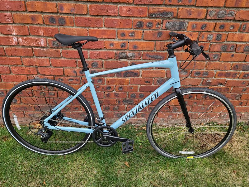

Anyone want this? XL Sirrus 2.0. I put a road fork and wheel up front because the stock fork was damaged in shipping. Brand new, never ridden. Except for the front wheel. Otherwise, dumpster.

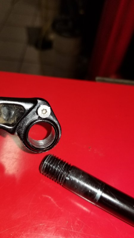

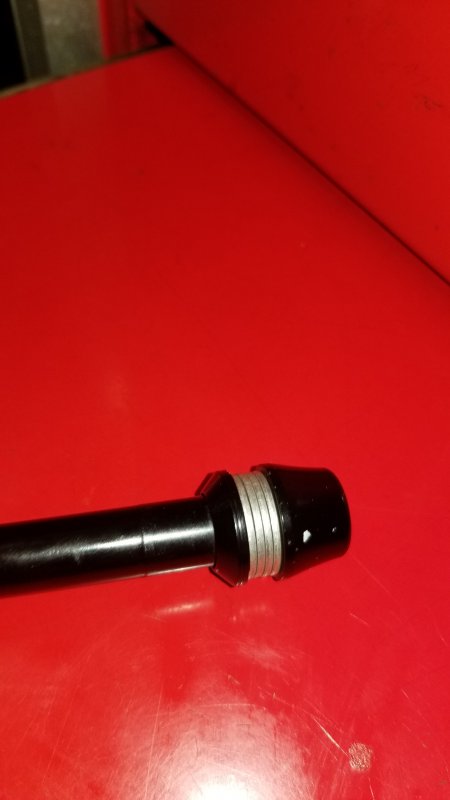

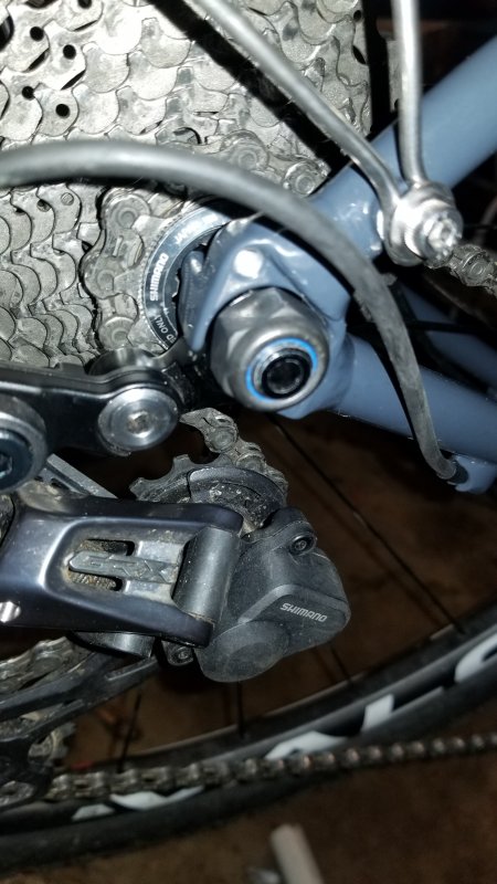

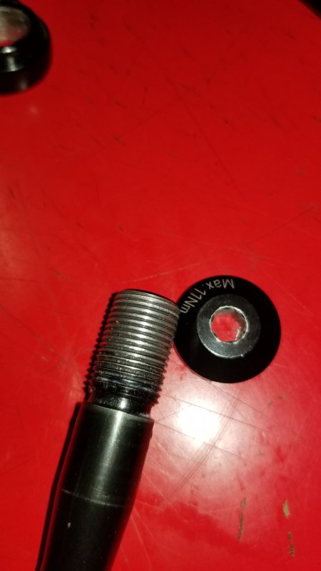

Yesterday I tried putting my gravel bike on the trainer to dial in my fit a bit better. Stripped out the mech hanger.
so today at work for the first hour. I drilled out the hanger. Had a longer bolt from my pivot 429 trail. That will now go through the hanger and have a nut outside the hanger . Had to cut off the tapered washer from the old bolt.
I may have get a different nut or just grind I'd down to fit the frame. Hope it works. 🙂
EDIT.. Not as terrible as I thought it would be.
