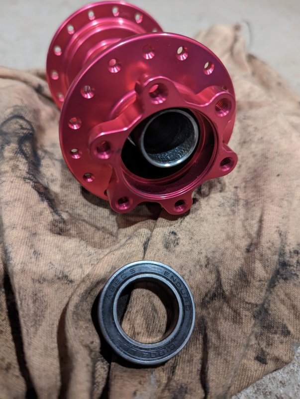

Replacing a cracked hub but don't have a bearing press. Should this be a diy or better to bring to a shop?View attachment 205407
Using a deep socket/regular one (if long enough) that is just slightly under the diameter of the bearing is the best "kludge" method. You can still screw it up by hammering it in crooked.
Relatively low risk, though.

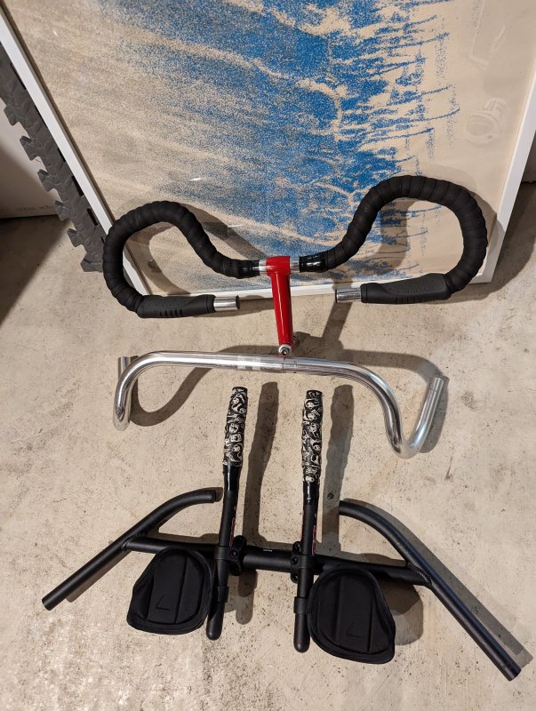

Have you looked at this? It’s a whole system but you can just get the bar…..I've been planning an update to a touring bike for the "multitude" of centuries I'll be doing this year. Rn it's setup with brifters on Cowbells and was planning on switching to TRP levers and bar ends. But with the hand arthritis kicking in the past few months, wondering if a different setup maybe worth considering. I really like the hands on hoods but need a variety of hand positions to give my herniated discs a brake from time to time. Looking for suggestions on bars with many varieties of hand positions.
Interesting but too much flare doesn't agree with my wrists. Can do max 15 degrees. Have Ritchey Venturemax which are 24 degreesHave you looked at this? It’s a whole system but you can just get the bar…..
Kitchen Sink Gravel Handlebar System
Redshift Gravel Bike Handlebars are specially designed drop handlebars that increase comfort and endurance for long gravel rides and bikepacking trips.redshiftsports.com

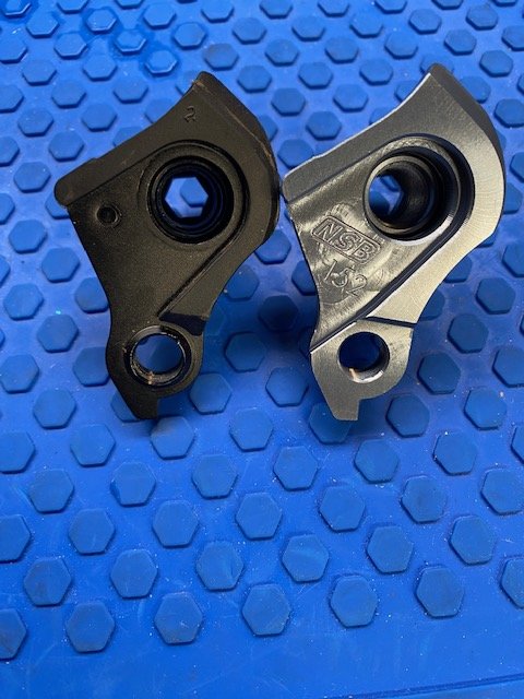

Doesn't the Stevo use a UDH? Just checked a couple of the more well-known online bike parts retailers and they both had stock as does Amazon.I hate not riding with a spare derailleur hanger (I once had one bend when my bike fell as I as taking a pic). The Stumpjumper Evo hangers are mostly unobtainium, save for the dentist version, so that's what I got (North Shore Billet). Gotta say, the OEM one feels like plastic, but at least I have a spare now.
