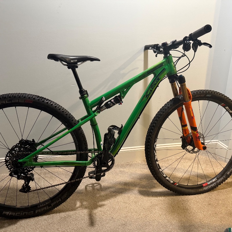

That's impressive for a AL frame. Is that a small?I swapped a bunch of old parts to my kids bike. Fork, wheels, Brakes. I think that’s it.

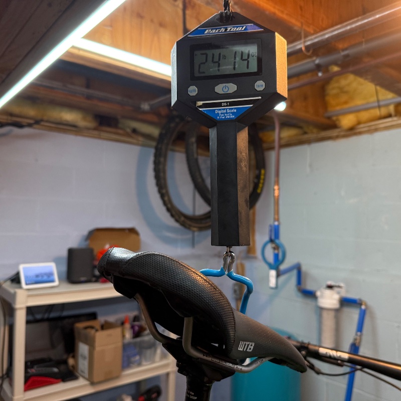

Dropped four pounds!!!
Steep is the new slack!Man, look at that head angle!!
