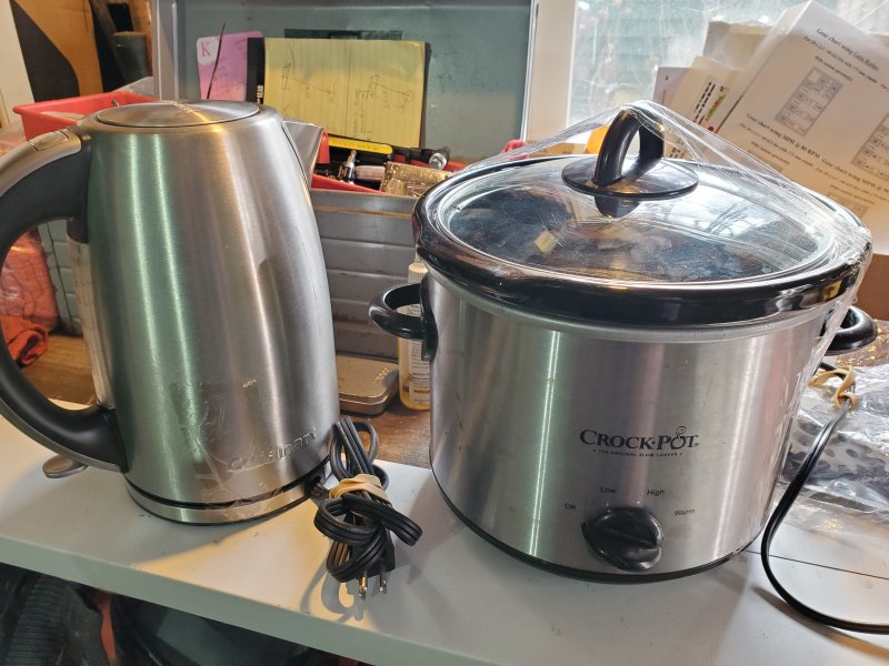

This is the crock pot I use, aside from taking a bit to warm up its perfect for this
That looks like the perfect size and price.
I used an extra one I had around and don’t use, because Dutch oven > crockpot. Don’t mind the time for it to warm up.

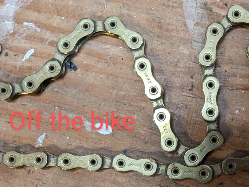

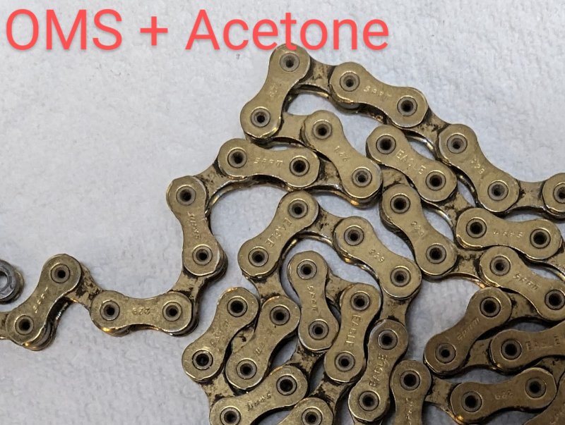

Finally got to wax the MTB chain. I'm starting with a used chain that I prepped with the Silca chain stripper. The chain was in pretty clean shape to begin with. It's been lubed with mostly rock n roll gold so it wasn't super greasy and gunked up. Still, there was plenty of cleaning needed, see pics below.
I started with a mineral spirit soak, acetone rinse, then water rinse. Since I already had everything on hand and ready to go, I figured it couldn't hurt. I let it soak in OMS while I cleaned the cassette so it wasn't really wasted time.
I then went to the chain stripper, ~10 mins of soaking with a few minutes of agitation along the way. I took it out, rinsed it, and determined it needed another round. After the second round of chain stripper I figured this was as good as it would get without a whole lot more effort. I was also running short on time, so into the wax it went. I'll take it out after the kids get to bed tonight and put it all back together. I was able to clean the chainring and one derailleur pulley during the two rounds of chain stripper, so all in all it was a pretty quick and easy process even starting with a somewhat dirty chain.
View attachment 232307View attachment 232308View attachment 232309View attachment 232310
I have that one too
Popped some tags in the local Goodwill store. 2qt Crockpot and Cuisinart electric kettle for boiling water to clean the waxed chain. $9.99 ea. There was an Instapot available too for $24.99.
