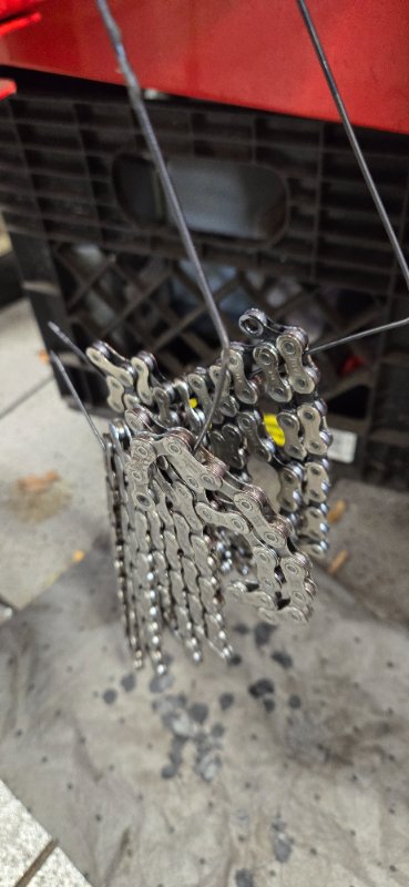

I did wax both MTB chains at work today. They seem happier now..View attachment 241809
