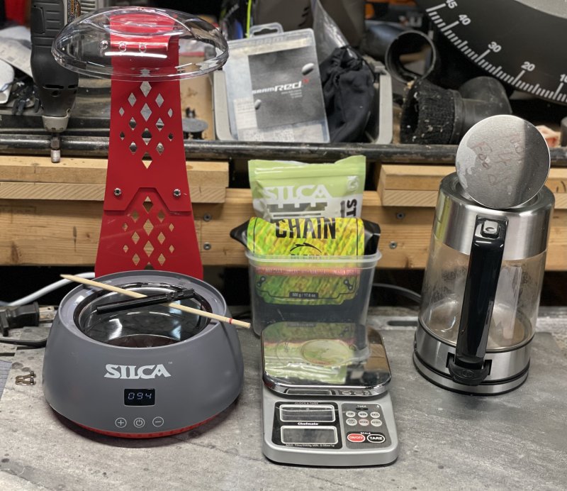

This is definitely quicker…
Note to self for future reference, the black handle gets f’ing HOT!
*edit: photo taken on the way down from 125c to 75c.
I do like the idea of upgrading to the crockpotinator. It's likely in my future. Maybe once my crockpot finally gets low on wax?
Sooo, here are some unsolicited observations.
I was using molten speed-wax in a crockpot before (smallest one). Took an hour+ to heat up on low. (High gets too hot, damages wax…allegedly). Full disclosure, I was using more than half a bag of the stuff so I’m sure the melting time was unnecessarily elongated. In contrast… using the C.W.S. at the proscribed fill level (worked out to about half a bag) it took 20 minutes 4 seconds in a 50° basement to melt the wax and strip chip. 10 min @125c and 13 min flat to get down to the magic waxing temp of 75c. So… it’s quicker and no more multiple rounds of shake shake shake in the nasty juice prepping the chain makes it waaaaay less annoying.
Down side(s) over the crock/insta-pot method? No room for multiple chains at the same time and you can really only strip one maybe two chains per strip chip and I’m not clear if you need all new wax after using second/third strip chip. Just re-waxing is of course, a non issue.

I experimented with this yesterday. At about 110c and a 10 min soak in the Silca crockpot, I hung and lightly shook the chain until the wax started to harden. The chain was very easy to break the wax when compared to removing at 75c. I don’t know (at this point) if that will decrease the time between applications, though, since I’ve only started waxing.
Also tried 95c without lightly shaking, and didn’t notice a huge difference between that and breaking the chain at 75c.
