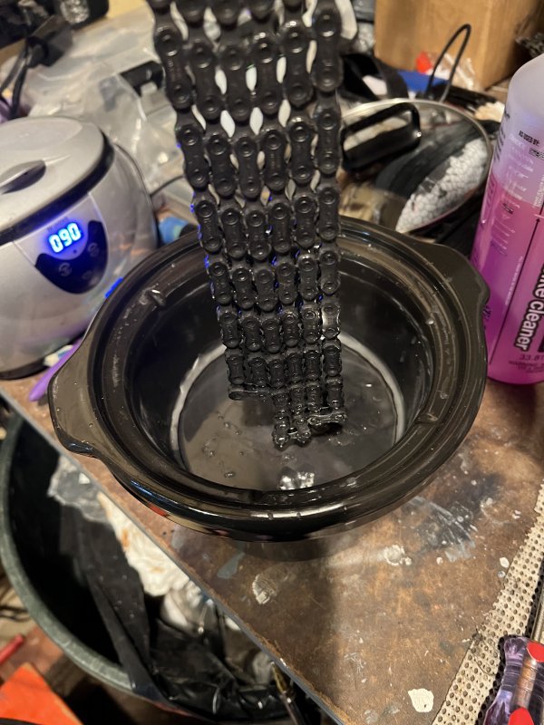

When you immerse a chain in wax, the wax gets in between the pins and the rollers and takes up all the space in there. Eventually, after 150-200k (on road in good conditions) the wax works itself out and you need to re-apply. But even as it works it’s way off the chain, the wax isn’t sticky and contaminants don’t stick to the chain.
When you use an oil based lube, dirt and dust stick to the chain and work their way into this area between pin and roller which is what causes a chain to wear out. As I’m sure you know. This is the premise for why waxing works so well.

Getting inside the pins and rollers is one of the main problems with wet or any of the surface-application lubes - not a lot of the lube actually makes its way into those spaces. Because the chain is completely submerged in the molten wax, more of those inside surfaces can get covered with lubricant.
I’ll send someone a few take-off links of chain so they can do the wax-guy sonic-clean and crock-pot, then return to me. I use the equivalent take-off links to clean and lube in my non-wax-guy method.

I forget what marketing material I saw from Silca, or maybe it was that the price came down? but regardless I am in the waxing game. I think what sold me was that you could melt it in the bag, in boiling water. Well, that turned out to be a PITA and I bought a mini crock pot for $15. In any case, it is kind of amazing how clean the drivetrain stays and I did get caught in some rain last week. I have 200 miles in on the EVO and now did the mtb. Will report back.

Not sure this will be useful for others but my impression is that unless you are very disciplined in how drip wax is applied to each link, it is better to trust the full chain immersion method. This means I don't ever apply drip wax, I just rewax the chain more often. This is easily done while working from home because it takes a while to get the wax to melt...I simply do it while working. Then when the wax is melted, I pour boiling water over old chain, move it around in its dish to shake off any remaining old wax or dirt, cool the chain off, wipe it with microfiber cloth, and drop it in the melted wax...then it is important to move/agitate the chain around to let the wax penetrate the chain...you'll see bubbles.
