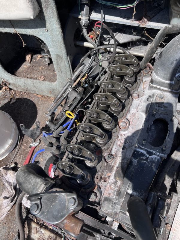

Pulled the valve cover gasket - looks great.
I would check those clearances now that you’re there.

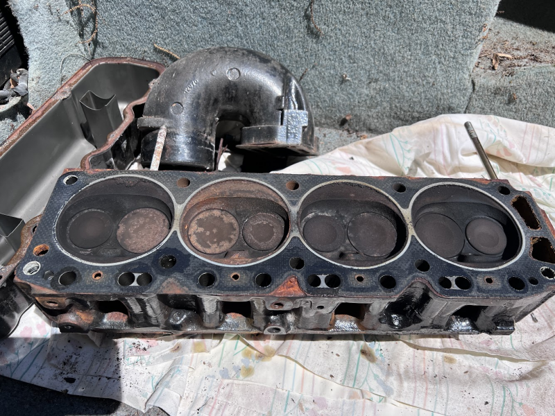

I guess i could go put it on the bench and pull the valves. i was expecting much worse. #1 is on the left.
no sign of a blown head gasket or crack - i didn't expect that anyway. Cyl walls look fine.
i just don't feel like working on this now. I have a couple days to remove the working parts, then off it goes.
i do have one more idea. not pretty.

Looks like it should run. Very clean for raw water cooled. Gotta be a freshwater boat.
Was there a leak down test? Did you crank it with the valve cover off and verify all rockers were rockin? Is oil getting up to the rockers?
#1 piston up to mid stroke and soak with MM oil in cylinder for 2 days. Work back and forth with breaker bar on crank pulley. Gently beat the piston top with a mallet to a wooden dowel maliciously a few times. Same with the valve stems. Reassemble. Pray. Twisty twist the distrib to the magical spot and you should be good. If not cost you gaskets.

hissing from the carb on cyl 1. I was sure i was going to find the head rusted to crap.
looking at getting a gasket set now.
