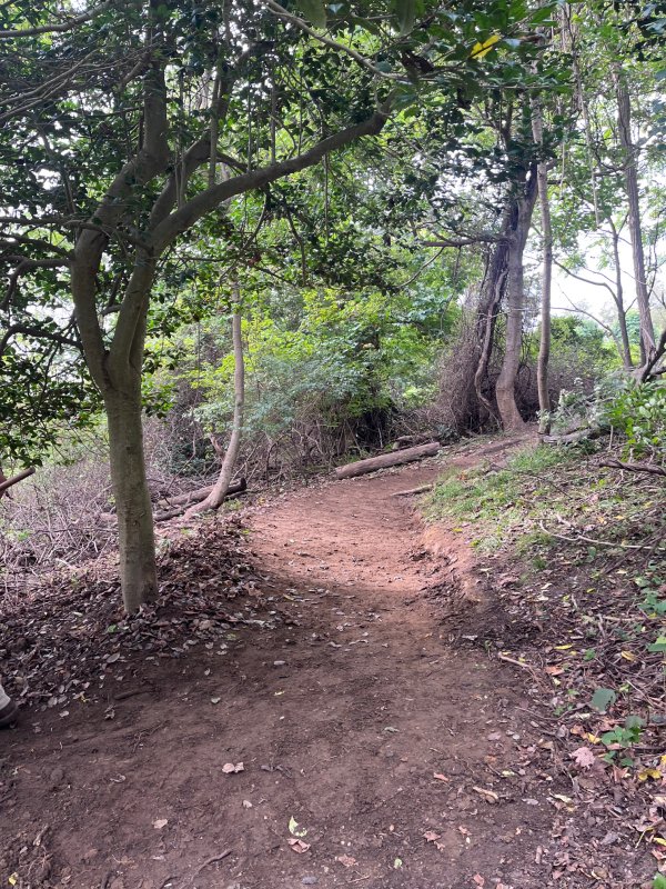

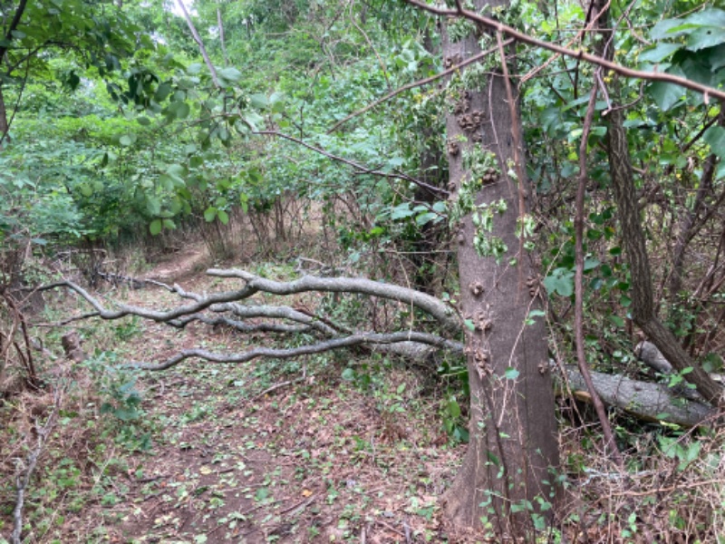

Tree down on the trail to the overlook by the devils elbow, broke off the small pieces, but didn’t have a saw.

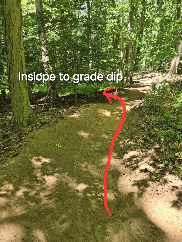

We rebuilt this connector two years ago, adding turns and drainage points. Overall it's still a bit too linear given the sandy soil which is prone to erosion, but I did not want to take land for a proper reroute with grade reversals given the delicate native plants in the area.

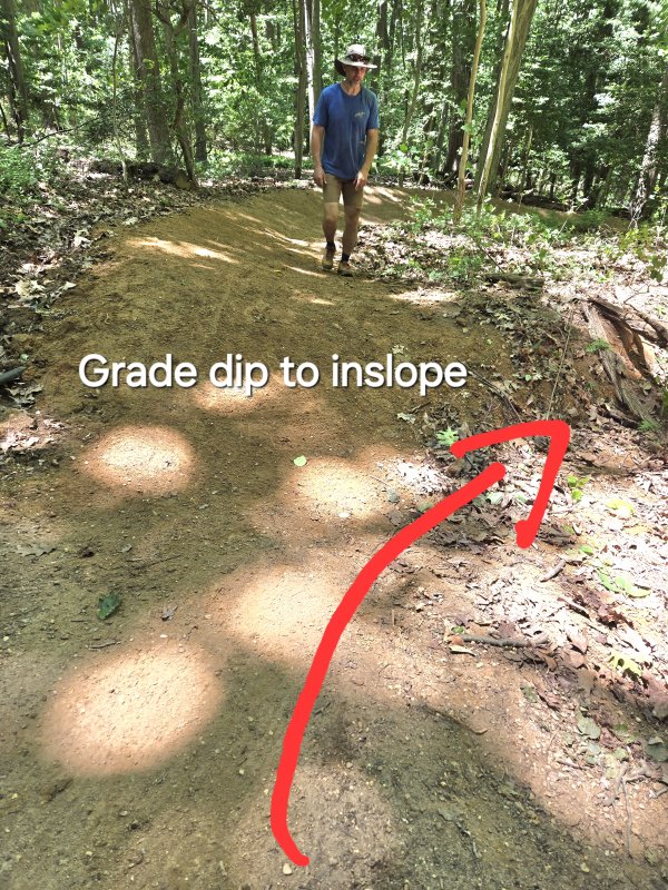

The alternative is more engineered trail within the existing footprint to drain water and have the trail hold up. Basically every turn (I think there are 4?) down the hill follows a formula. Grade Dip/Inslope/Grade Dip.
This creates a more sustainable downhill and makes for a better trail experience.

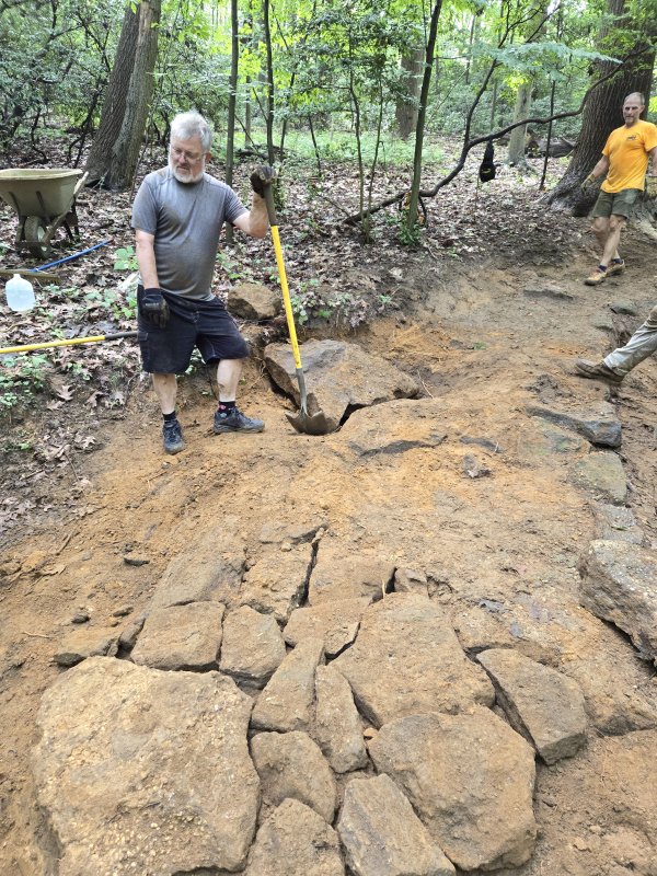

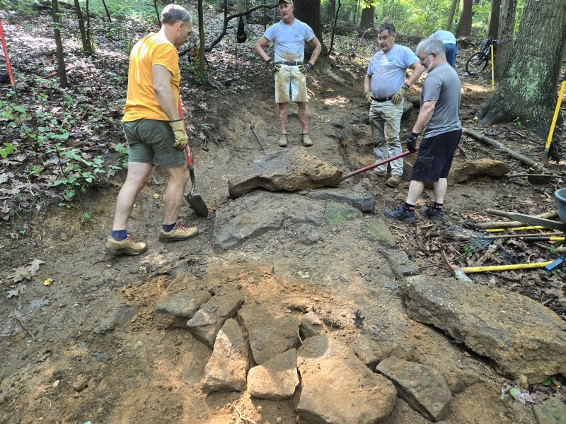

Going into the last turn required some rock moving to set the turn up and complete the radius. These guys spent about 1.5hrs getting this guy and smaller slabs into place. I rode it afterwards and it was man hours well spent, the arc was perfect and set me on a great line into the lower turn. I worked on armoring the straight line in between the turns to counteract brake bumps and erosion which forms on trails this steep with sandy soils. We use soil to fill in the cracks around the rocks to lock everything in place. After a couple of rains the rock will become exposed and enhance the look of the trail.

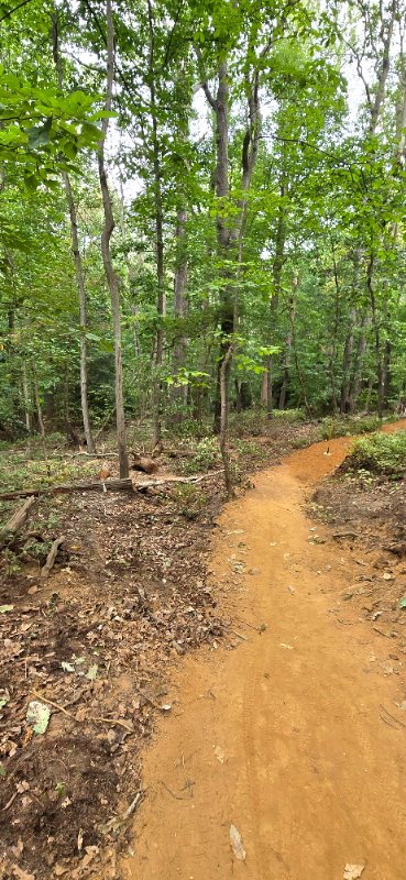

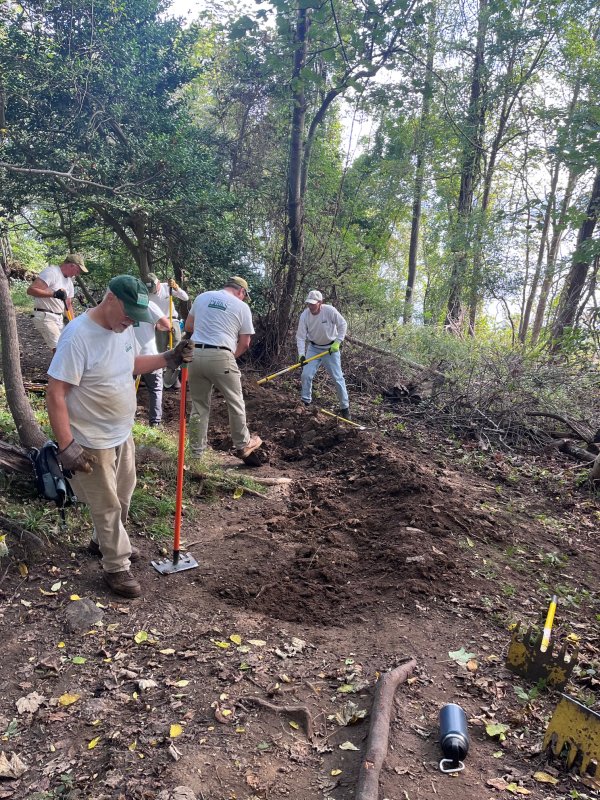

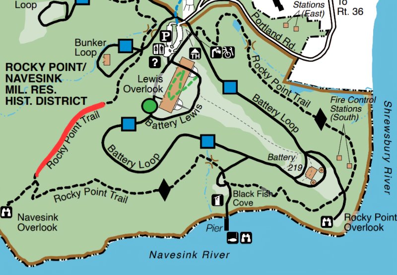

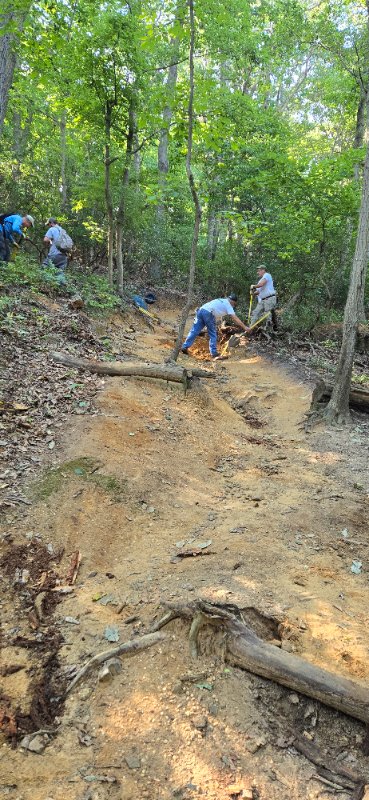

Today we finished up repairs/reroute on Rocky Point Trail. We started this in the beginning of August, near the top of the Overlook.
The worst part of this section was all the sand at the bottom of the hill. To correct this erosion we added grade dips up top, to divert water off the trail.
Basically we hogged out 1'+ of soil in a low point and graded to it. Cut and fill to create dip, put leaves/organics back to define trail and give it a finished look. We did 6 or 7 of these.
Further down the erosion was worse at a steep section, we added a grade reversal reroute.

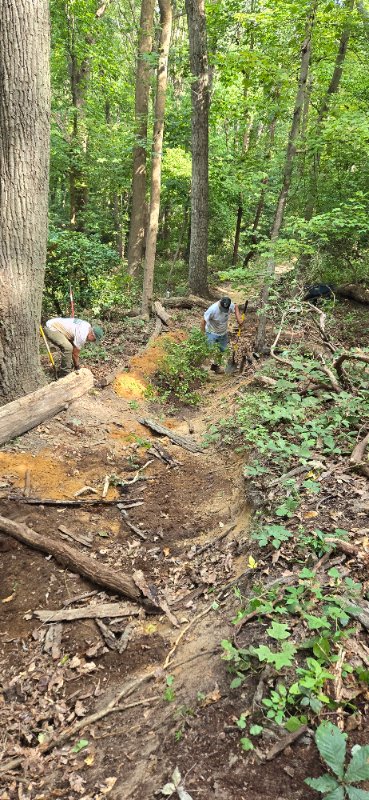

Digging grade dip before adding grade reversal.
The old line went downhill to the left. We put reroute in, turning right and uphill for our grade reversal.

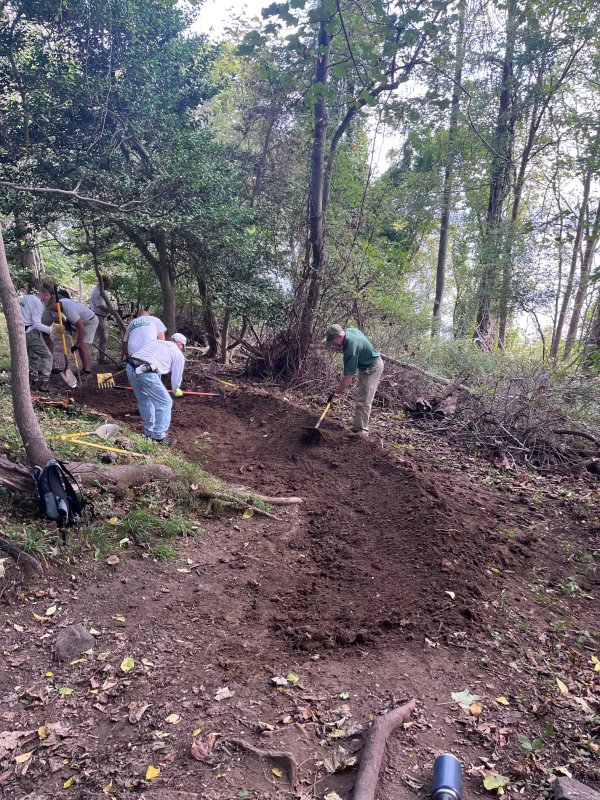

While building this, closing the old line was as important as building new one. We transplanted plants and moved organics from new line onto the old one. The drought has been hard on our transplanting, but at least the organics are there for recovery.
Stripping topsoil and organics off of new line and filling in the old line.

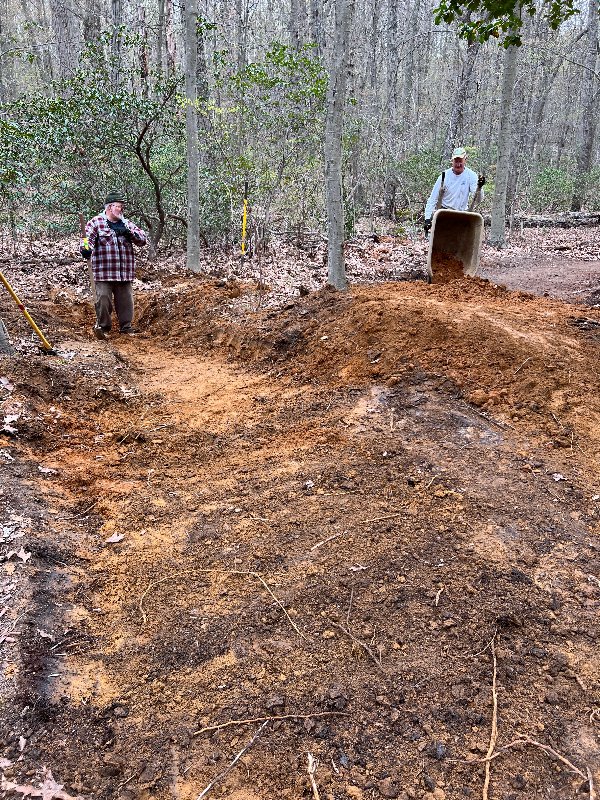

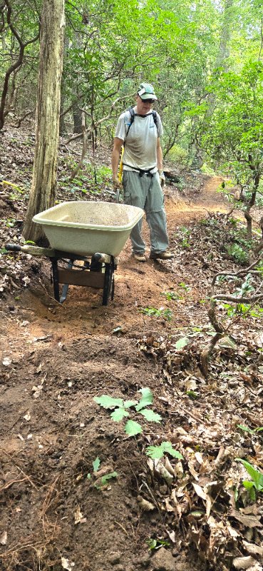

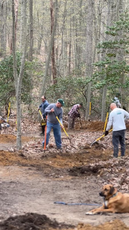

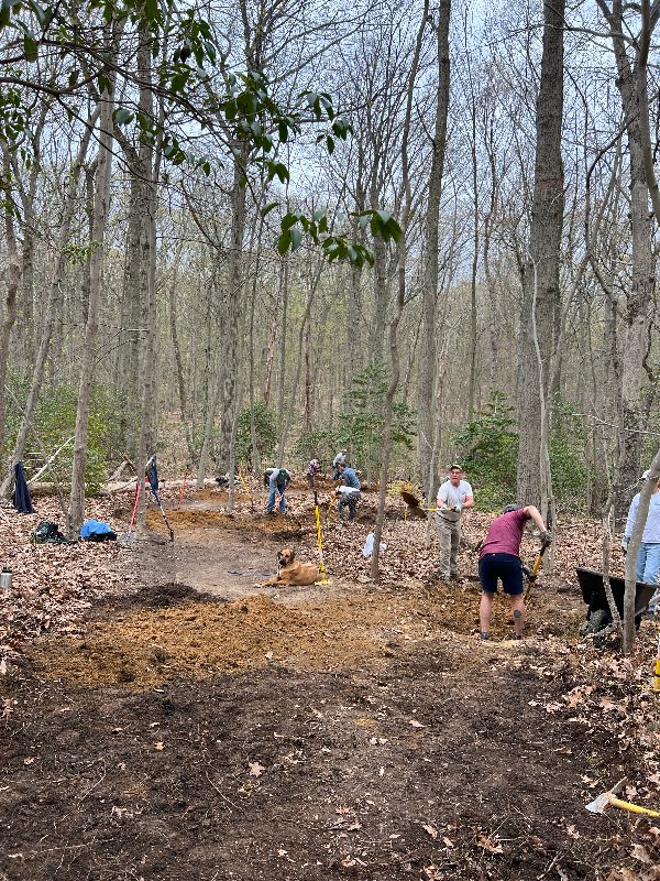

This TM we hand dug 3 grade dips on the reroute while Iggy was in the Bobcat doing massive remediation on the Cuesta Ridge trail.
Steve M, Chris, Larry and UK Steve (oh and Bob's dog lol)

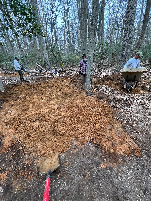

All 3 grade dips in progress.

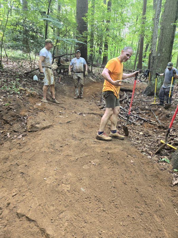

Larry and Roland on the 3rd grade dip. Those guys dug a massive trench and we used that material to create the rise. Between the 2 water should shed very well off the trail for years to come. We gave it some bank/slight inslope on the tail edge to help guide people around the bend.

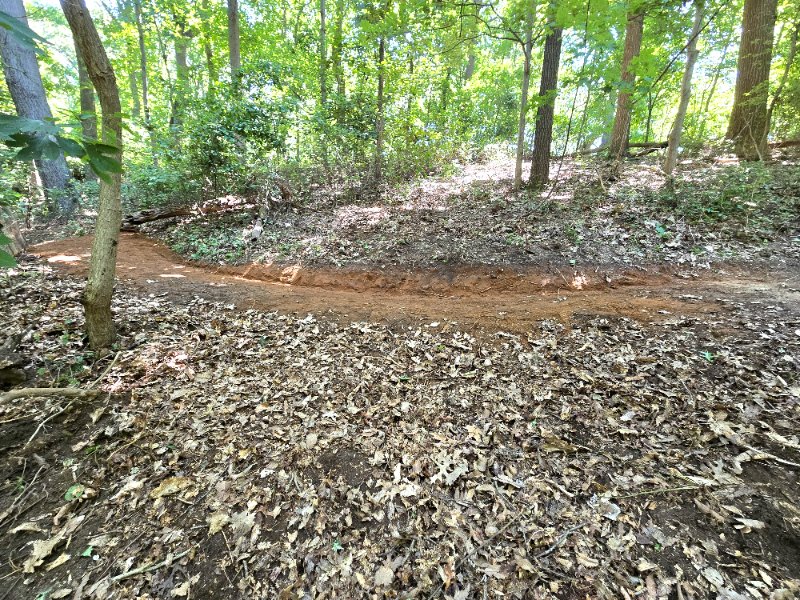

3rd grade dip looking up trail. Roland is well over 6 ft and standing in the drain trench they cut out - so it shows it's pretty deep. The guys backfilled with duff and then leaves so it barely looks like we touched anything. Knobby is working on the throat of the grade dip. Giving it that special shape where the water drains but it isn't too outsloped so traffic doesn't have too little traction.

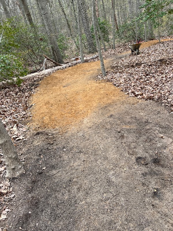

3rd grade dip looking uphill at the end of the TM. This crew works so fast that we were done with this before noon and a few of the guys moved more organics into the old section of trail so things can start growing back.
Downhill view of the 2nd grade dip and slightly in-sloped turn after it. Many barrows of dirt were used to make them and where they were excavated from will act as a catch basin for downhill water flow. Again with duff and leaves on it the section looks barely touched even as you walk by it. Kind of a shame as the holes these guys dug were substantial!
