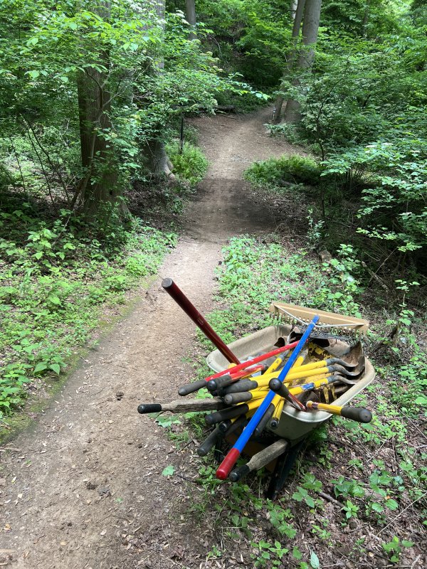

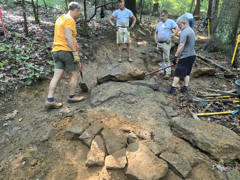

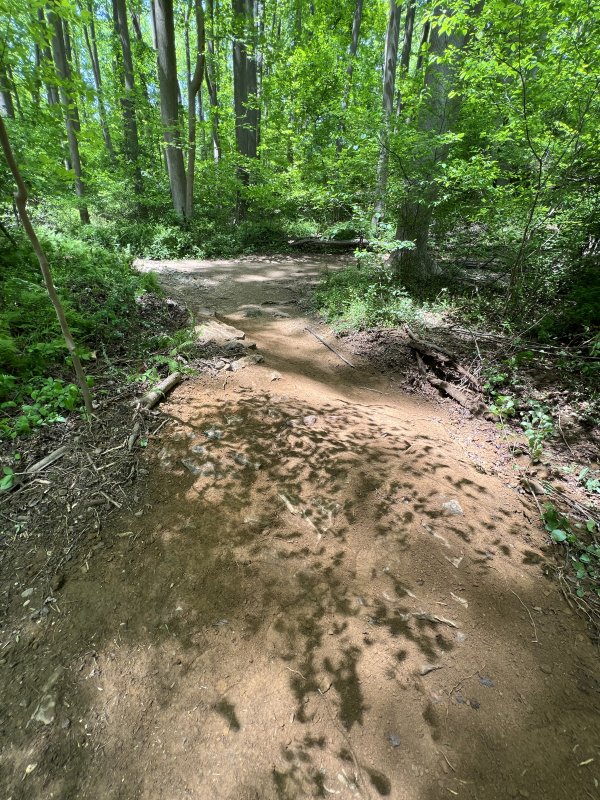

A little update on the work we did yesterday. @pooriggy was in the field continuing with the fresh cut trail with some of the TM crew. @smann , Andrew, UK Steve and I were in the woods up trail working on some of the water control.

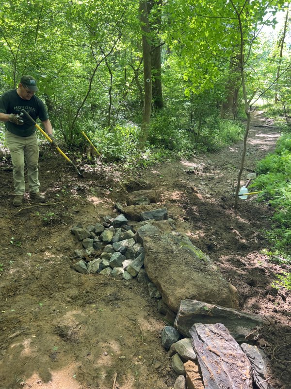

Pic of the area just as we started. The guys brought out some nearby rock for armoring and we ended up using about 20x more of this amount. The Grand Tour sign on the tree is good for perspective.

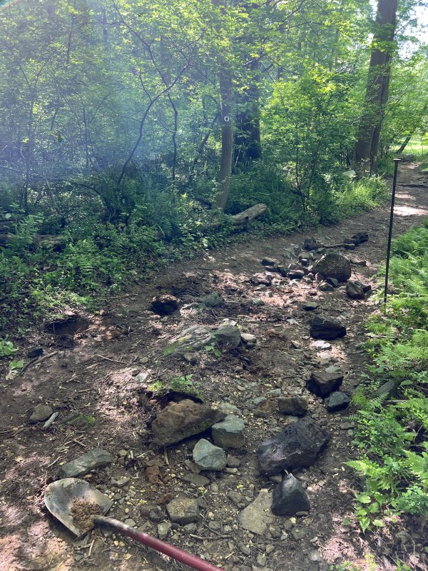

I noticed a lot of big stone sunken in when I previewed this area on Sunday to put some mental notes together for the Monday TM. The crew worked hard and this was the biggest of the stones we broke out. Andrew is not a small dude - it took all 4 of us with rock bar and shovel to pry it out and set in place.

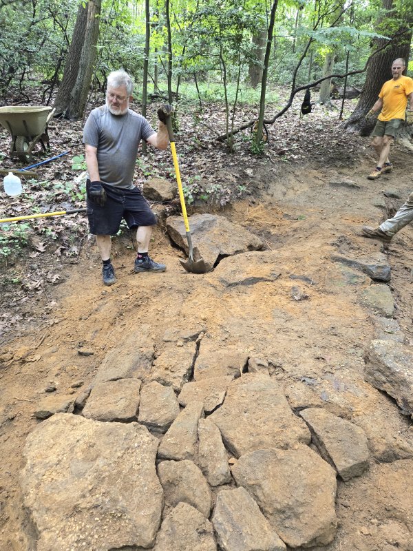

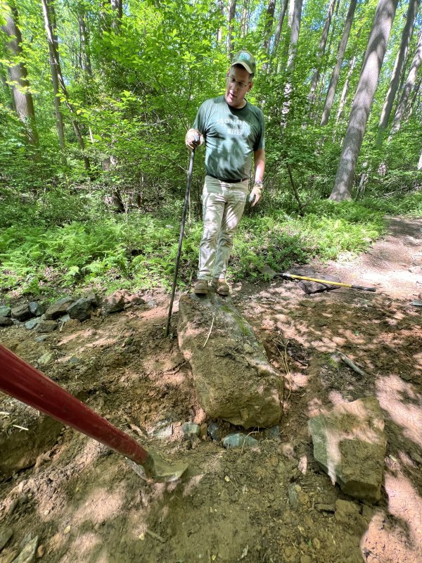

The lads at it. These guys move fult tilt! The hole where the large stone was, was filled with the old quary stone that didn't do shit and was strewn all over the place. Having larger stone hold it in place should keep it in the right spot.

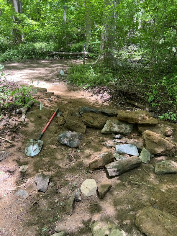

We popped out a half dozen more good sized rocks and continued with the drain wall. With that beautiful stone I felt like some organics on the right side of it would help hold the rocks in place, keep the water from breaching and going back on the trail and also look good. So we transplanted a few trees and ferns and added leaf matter to make a natural bed.
The guys had to leave so I stayed for a little more to massage the final rocks in place. Like the Jims they are such beauts that they wanted to help bang it out but it's more mental/jigsaw work and doing it solo wasn't too bad.
This is what I came up with. Looks like mostly dirt but the amount of rock in there is huge. With rain and use the material shoudl filter down, lock things in place and create a nice texture for hiking and riding. All the while bringing the rain water off trail.

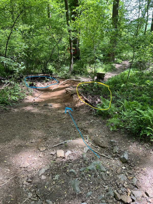

Broader view looking down trail
- blue arrow - runnel line that stayed on trail creating issues further down. We just followed the line straight for water exit
- yellow circle - where the old runnel line/trail - now some organics
- blue circle - new exit for water - the natural slope came down 2 ft
- white line - new bank and tread - the usable trail is wider now. It seemed it was getting pushed over between the loose quary stone and erosion and users looking for a smoother/drier line. I also banked it so it will be off camber for the water drain but then in slope to hold you for the second part as you get back on the main trail.
- red circle - Grand Tour marker sign

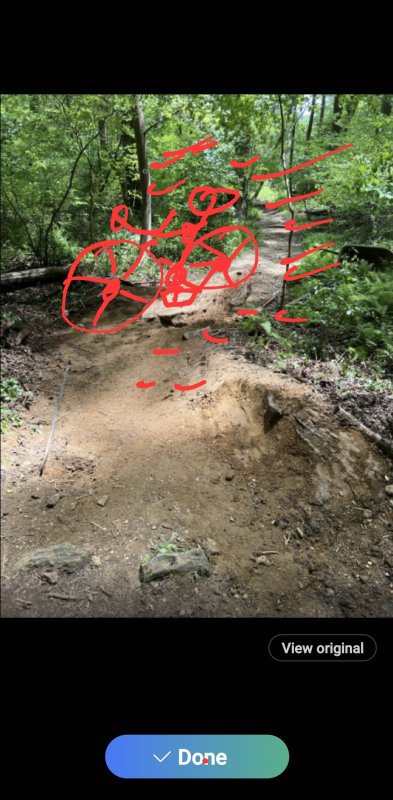

Rock wrong place. Belongs on lip. Then bike jump off big rock.big rock put big smile on face.

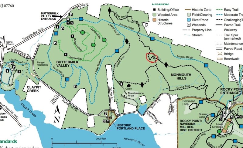

We have been hand tool working in the circled area while @pooriggy and Austin have been doing machine work in the Monmouth Hills open area.

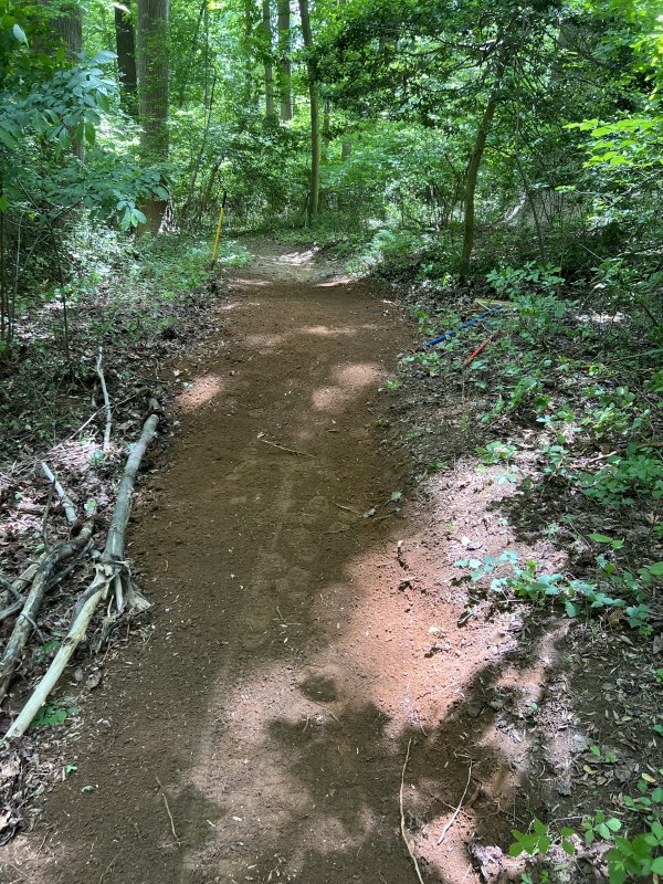

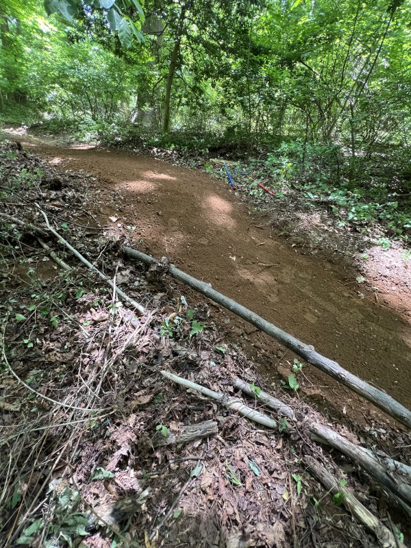

Last week @knobbyhead did a ton of pruning as the trail was getting tight visually and holding moisture from the rains. He also took out a bunch of invasive plants.
The rest of us created a drain and roller to make sure any left over water will dip off the trail. It doesn't look like much but it was a full TM with @ChrisRNC working on some fixes to it yesterday.

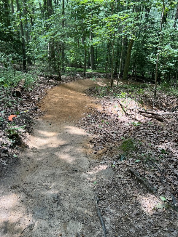

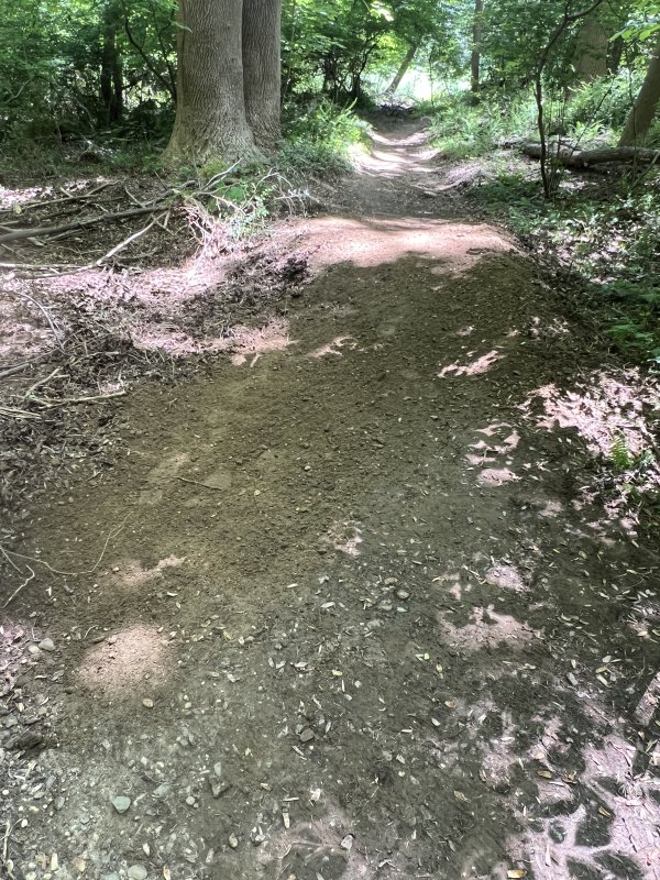

Yesterday a few of the team (Brian, Roland, and Andrew) created a dip grade before the sharp and steep turn (that's just before the intersection going downhill on GT). The sharp drop has some erosion issues but has stabilized in recent years and is short enough that a dip before and after it should keep the current feel and flavor of it. Again it doesn't look like much but those 3 guys can dig and they were working on it the whole TM. The first pic is looking downhill right before the sharp turn to the left where it drops.

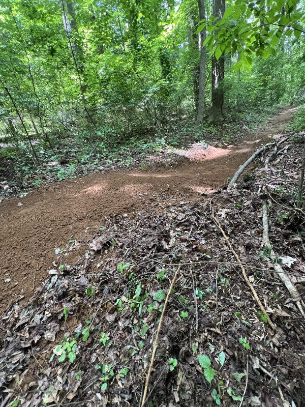

Just around the bend Steve and I worked on a long grade dip to make sure any water from the steep drop got off trail and make it a little more interesting ride wise. @ChrisRNC helped us with the final touches after his spoon build.
Side views - it ended up being a shovel and half of bench in the middle and about 30 ft long:
The view looking up - Chris' rocks were put to good use!
Last one - chipmunk view

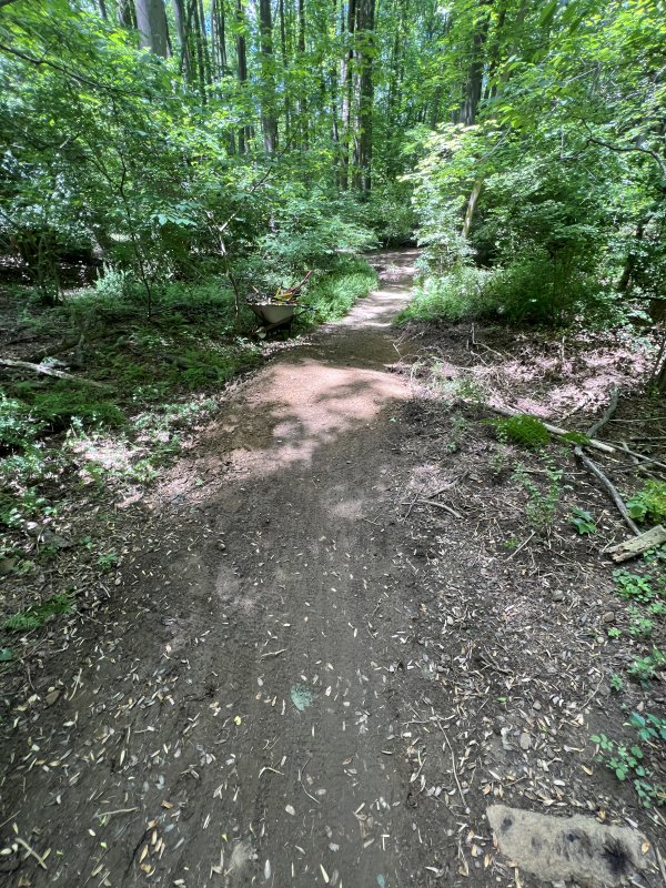

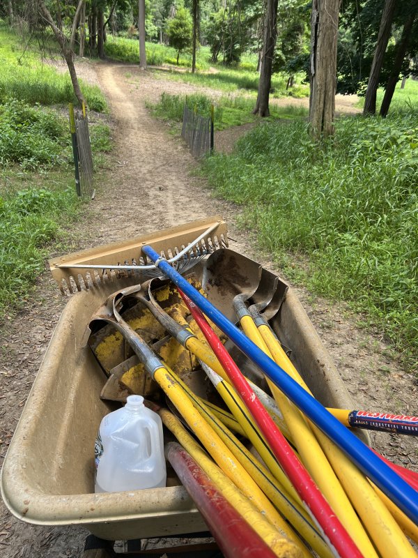

Partial view of the open area re-route Iggy has been working on. With the native grasses planted and a new better designed and built trail this area will be a great experience for years to come.

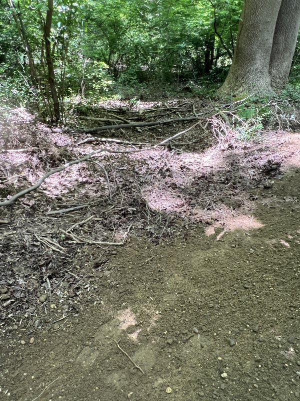

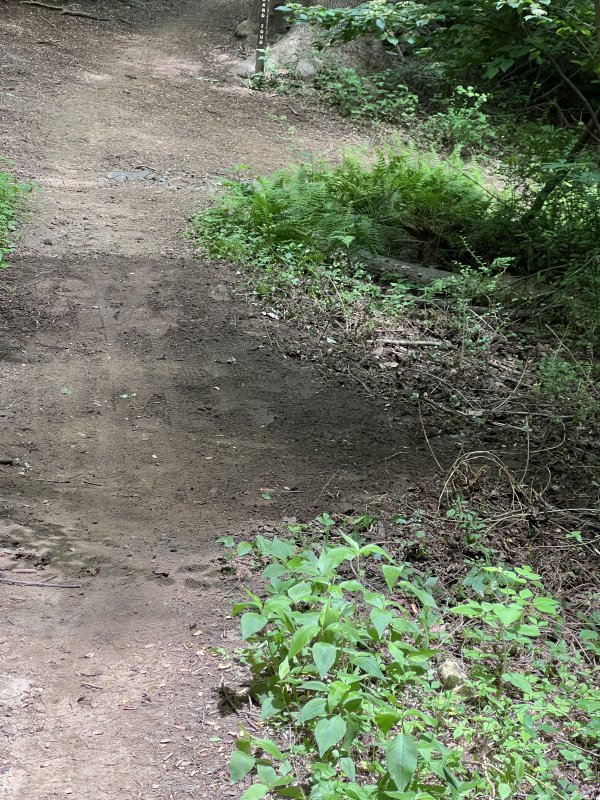

This is looking up hill towards the intersection and where we did a bunch of rock work a few weeks ago.

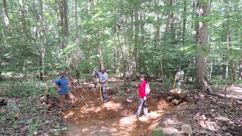

I got there late and the guys were patching up some drainage that we had done previously. @knobbyhead and Brian suggested some real earth moving to make a proper drain. After looking at it for a few minutes, they were correct. The old pits were filled with run off and there was really no place for the water to go.
Knobby took this shot when we were almost done with the excavation. Ken in the red shirt is standing where we took out 20+ wheelbarrow loads and the water should unload where Brian is with the wheelbarrow. Knobby opened the drain entrance which will help a ton in guiding the water off trail.
Another pic from Knobby - post fill in of the drain with organics and some packing and shaping of the roller where we piled the barrows
Another pic of the drain. Kind of a shame to cover up our grading lol

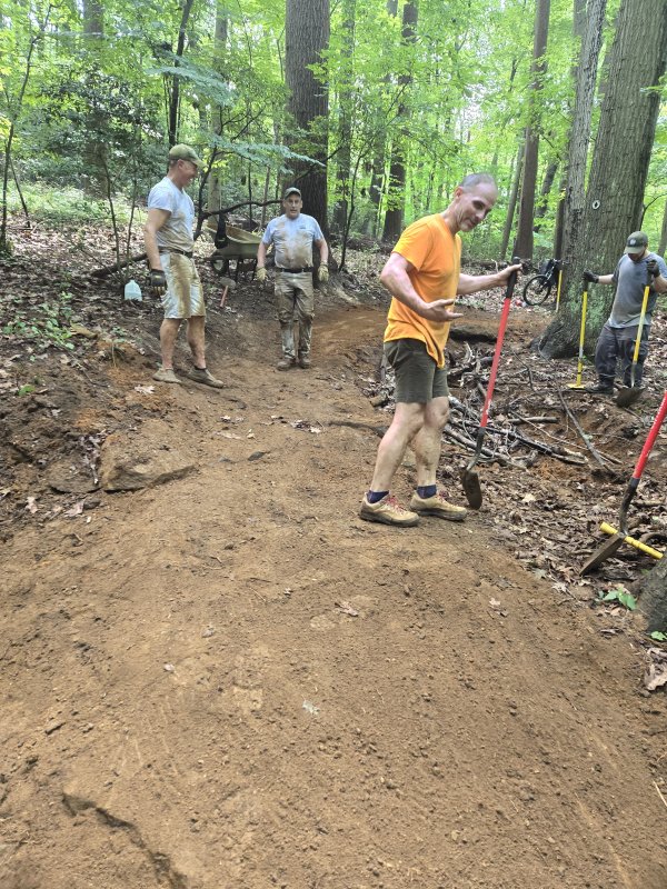

It was supposed to be a clip and trim day but with the cooler temps we ended up banging out some much needed fixes to the Grand Tour connector (which links Monmouth Hills to the Rocky Point area). We had done some re-routing in this area a couple of years ago and overall it's held up decently but we were able to improve it with some of the techniques and skills we've learned over the years.

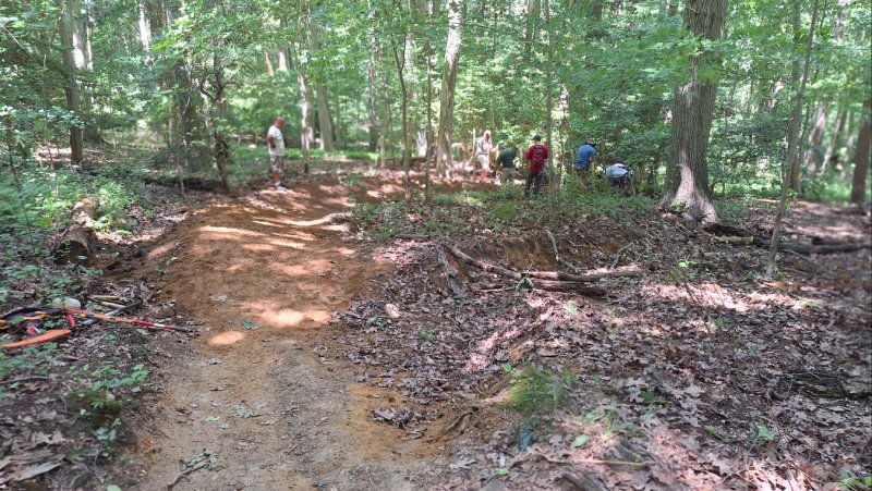

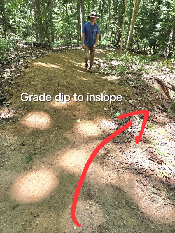

After @pooriggy and the other part of the crew finished up with the planned trimming Iggy came up and suggested some inslope for the turn after where we were working. There was inslope on it a coupe of years ago but the weather and use blew it out and we noticed a number of fresh skids so a fix was needed.
Looking down trail into the inslope turn
Looking uphill
I forgot to take a pic of the drain we did after this but it's a good size. I also added an inslope roller - so it should have a double roller feel to it for a little added zest 😀
Iggy has used this formula a lot at Perrinville - inslope turn to grade reversal/dip to shed the water out. Doing this before and after turns keeps the water off and make an enjoyable experience to ride or hike as there should always be a dry section of tread.

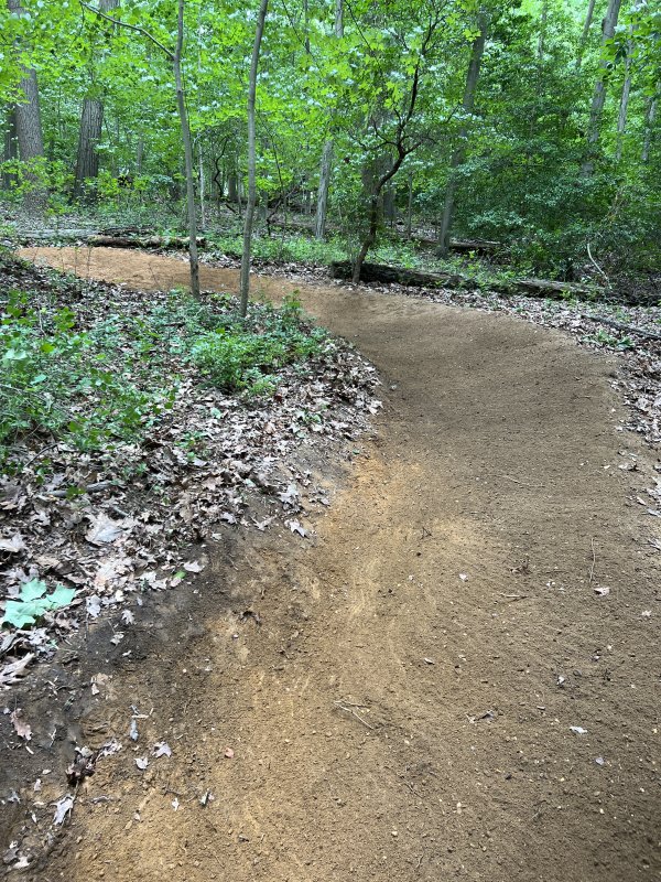

Thanks for noticing. We spent about 4 sessions working on this connector and I'm happy with the results.
We rebuilt this connector two years ago, adding turns and drainage points. Overall it's still a bit too linear given the sandy soil which is prone to erosion, but I did not want to take land for a proper reroute with grade reversals given the delicate native plants in the area.
The alternative is more engineered trail within the existing footprint to drain water and have the trail hold up. Basically every turn (I think there are 4?) down the hill follows a formula. Grade Dip/Inslope/Grade Dip.
This creates a more sustainable downhill and makes for a better trail experience.

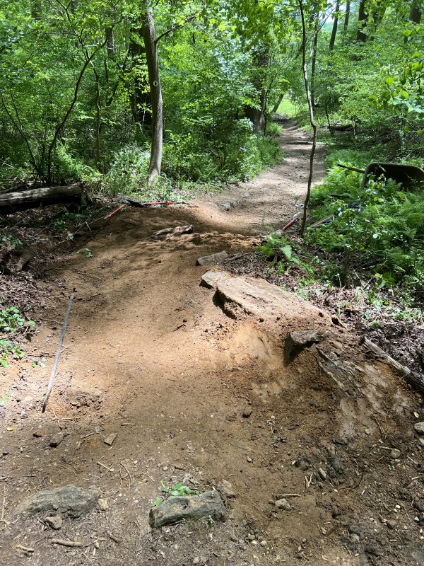

Going into the last turn required some rock moving to set the turn up and complete the radius. These guys spent about 1.5hrs getting this guy and smaller slabs into place. I rode it afterwards and it was man hours well spent, the arc was perfect and set me on a great line into the lower turn. I worked on armoring the straight line in between the turns to counteract brake bumps and erosion which forms on trails this steep with sandy soils. We use soil to fill in the cracks around the rocks to lock everything in place. After a couple of rains the rock will become exposed and enhance the look of the trail.
