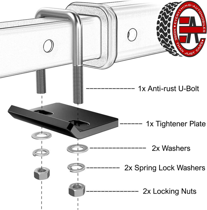

use an anti-rattle plate/bolt between your hitch and adaptor. Like this
I have an extender from my hitch so that my bikes don't hit my spare tire mounted on the rear of the vehicle. It did the same thing until I installed the above. Drove me nuts. You can get ones that fit both 1 1/4 and 2" transition adaptors.
This one fits the 1 1/4 to 2" transition because it has a larger flange.
I use this too, but it will not fit my new vehicle's hitch. So I swapped to this one, Iron Grip.

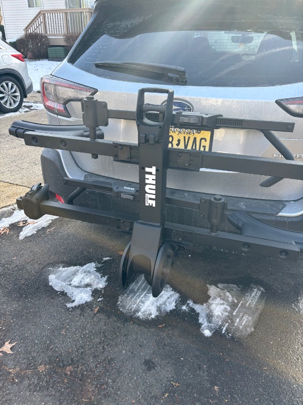

So tried a few different things including the adapter that @Patrick suggested (which my rack is not compatible with)…looks like I’ll be getting a new rack after all. Old rack will go back on old Subie.
@jdog got Thule 2” in shop?
Yep. Let’s chat on Monday.

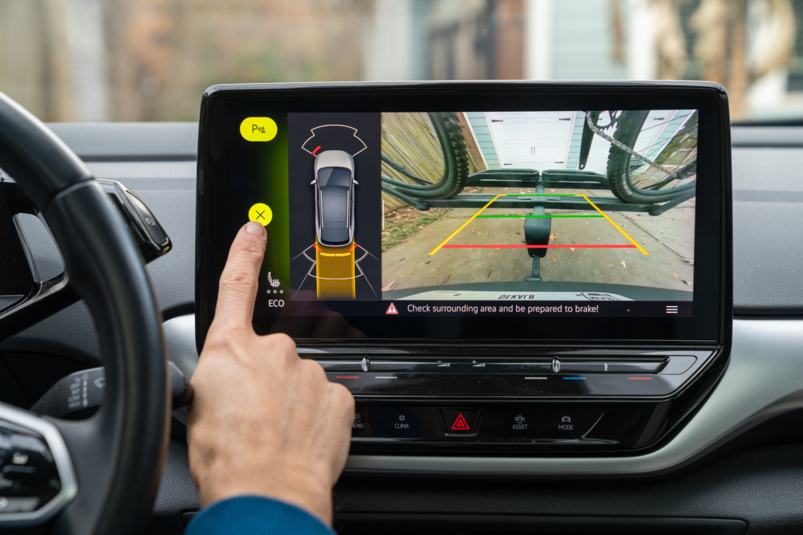

Never had a hitch rack- always a roof rack. Getting older and hoisting my bike onto the roof is getting less and less fun. Thinking of a rack- silly question- I assume most, if not all racks, will impact automobile back-up cameras. What is the typical impacts? I assume I will need to disengage and auto braking feature (which I will constantly forget to do) but otherwise is functionality pretty okay otherwise?
@NJ Gator mine blocks the camera. I’m used to it but it sort of sucks. I can see some stuff but don’t rely on it. My sensors still pick up movement to the sides of the car/parking lots
I have the same experience in my Subie, blocked camera. It's a bit annoying but then again I drove for 20 years without one....
The reverse auto braking does not kick in due to the hitch rack, however I get a constant beep in reverse (the warning that I'm too close to something). The cross-traffic alert (cars coming down the aisle when backing out of a spot) still works just fine too.
Also if you have anti-crash sensors, you'll have to turn them off. It's still beeps incessantly but won't auto brake. That's the reason I end up taking off the rack after each ride.
It seems to be vehicle specific, I don’t have to turn anything off on mine.
I have to turn off the sensors on a Toyota RAV4, the really annoying thing is the orange warning lights on the dash highlighting the fact that the sensors are off. The single one-up rack does not interfere with the camera.
It's not the lights or beeping annoyance, anti crash sees the bike rack and applies the brakes so I can't even back up
