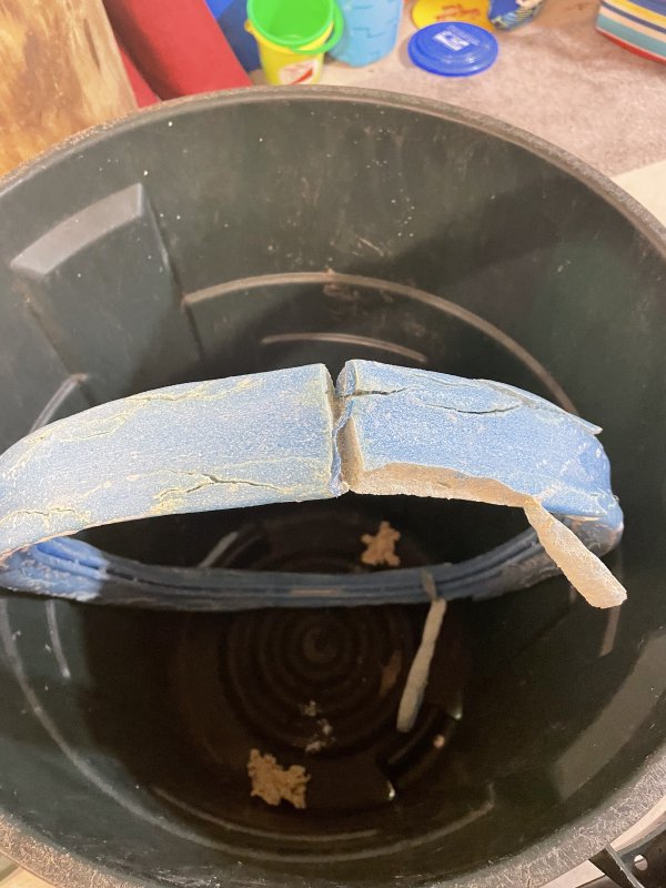

I think the cushcore xc is the best one I have used, 2 full seasons on mine now and they are fine, but they arent light
