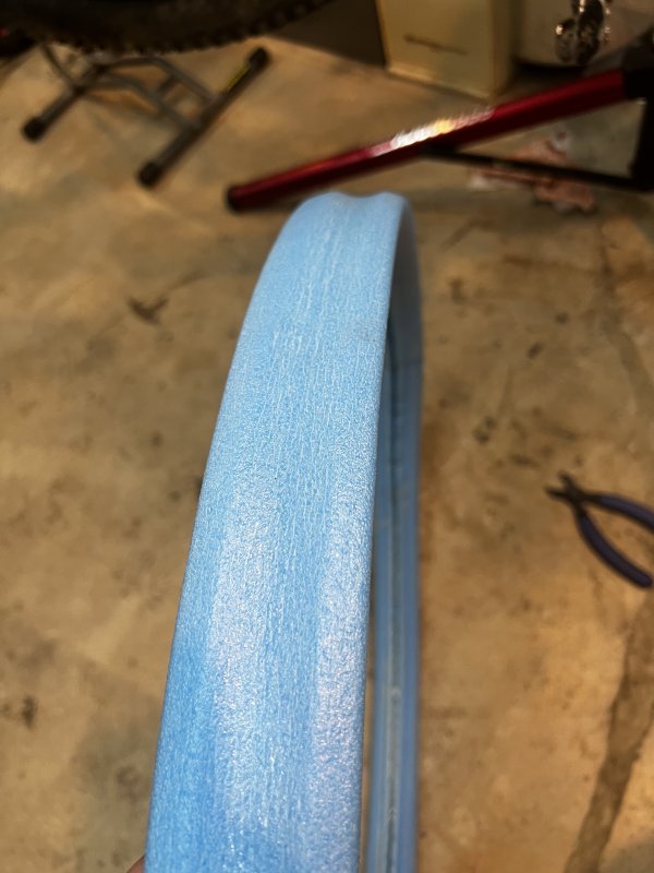

this was in my tire for a few months. Maybe they changed their foam, but mine is still in pretty good shape.
I changed @Riggedfmx 's tires this weekend and he has these inserts too. We reused them but they definitely have slices and tears from rim strikes and use. How often are you riding at Nassau vs RV/CR? That may tell a story. My front one was considerably better but I just put it in the rear so...
