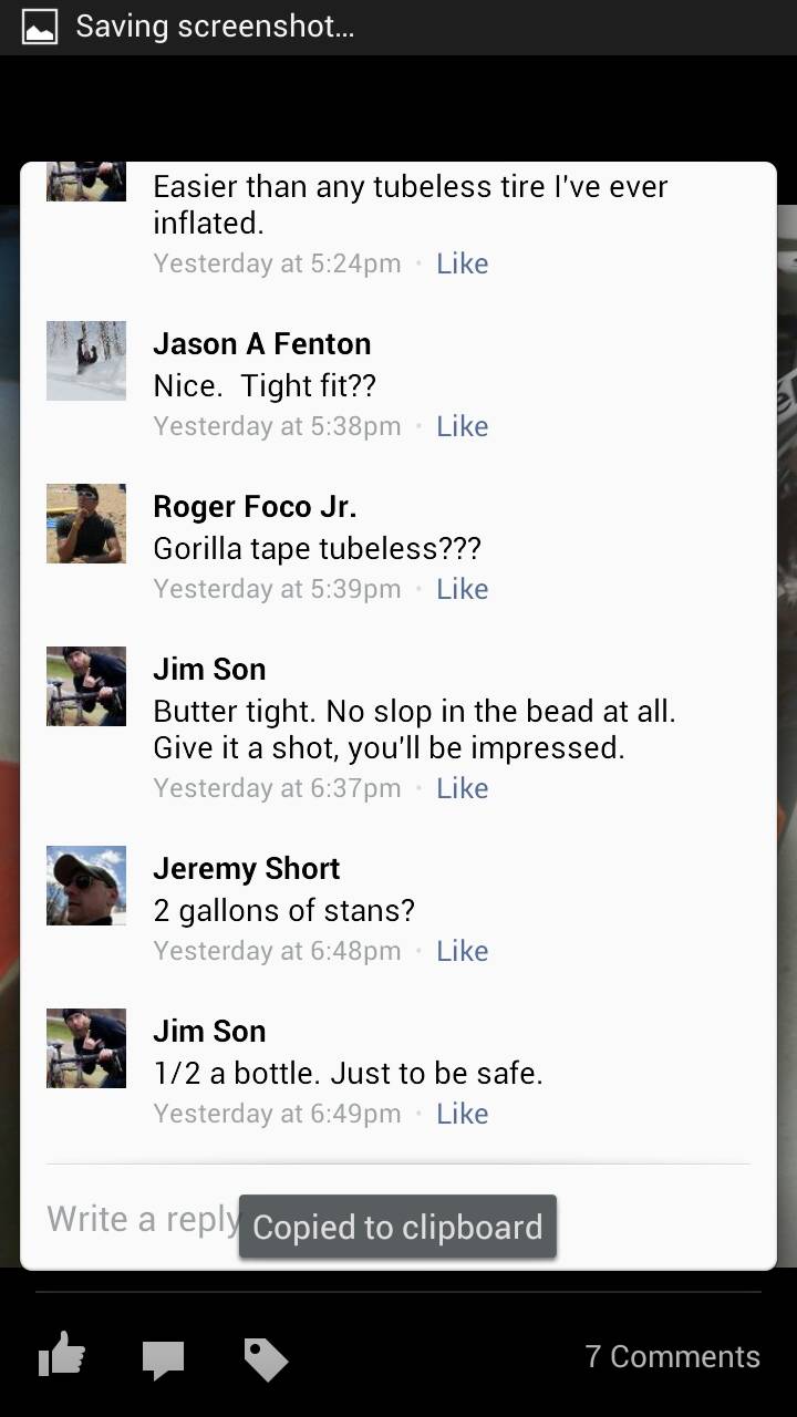

Just curious, do u use the full half gallon of Stans in each of those big wheels?
This. I used 1/2 of one of the smaller bottles. I don't think you need that much but I'm running 180tpi tires that are pretty beat up. As a reference, the sidewall on the Escalator is about the same as the sidewall on a standard Racing Ralph. A 27tpi tire would take much less to seal.

But can u get clown shoes with BFLs to seat and seal?..........if so..u will become the ULTIMATE fat bike guru...bar none
I'm sure you can do it, but it will take so much tape and foam it will weigh more than the tube 😀
-Jim.
