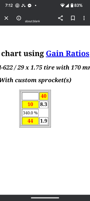

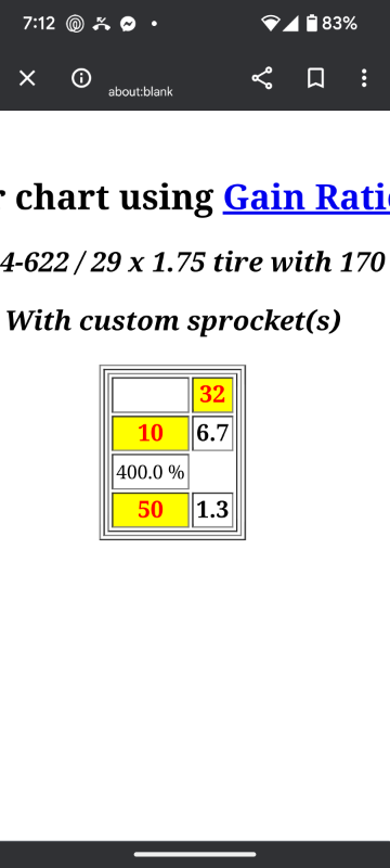

Best way to measure is by gear inches, since we're comparing different wheel and tire sizes. There are many calculators out there but these are from Sheldon Brown's site. Using the gearing from a Santa Cruz Stigmata, 40T chainring and 10-44 12 speed cassette.
and to your gear inches are
Note the different ranges in %, you don't need the jumps but to be realistic, 95% of the time you'll be on the high half of the cassette, where the jumps are smaller. So I'd focus on more gear inch calculation at "10". 8.3 vs 6.7. That's why Pearl keeps mentioning the front chainring size. The cheapest option is to install the largest chainring, maybe even use some BB spacers to offset more on the drive side. What's the max, you think you can fit? The largest my Carver could fit was 32T, which is why I gave up on that option.
