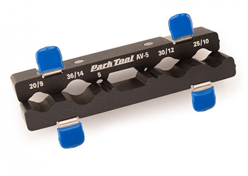

Anyone who knows me knows I love tools. It doesn't take a lot of convincing for me to buy a tool, no matter how specialized it is or how often I might use it. Hell, I have a Park CRP-2. Which is nothing compared to some of the specialized tools I have for working on cars.
Last weekend, a friend asked me to swap the hub body on her I9 Torch hub. An operation I've done a few times in the past, although not recently. Step one: remove the axle cap. Should just pull off... "Hmm... WTF? This MFer is on there...." So off to the Rectangle of Knowledge I go.... So it seems if the cap has never been removed before, it can really be a task to get off. Does Park make a tool for this? Of course they do... clickety clickety... a slight dent into my Discover cash-back balance... and one is arriving Sunday:
Blind bearing pullers work better 😀
(but the axle vise is way more useful in general)
Hmm, who knew? All these years I’ve been yanking them off with a slip joint plier with a rag over it to prevent most scratches…

I tried that method. Still wouldn't budge. If it were my own hub I would have probably said "eff-it" and lived with the scratches. But since it's not mine... Tool time! 😛
It's a thought... but the one I have is meant for larger diameters than 12mm. And I9 left very little gap between the axle and the cap for a puller to grab onto.
