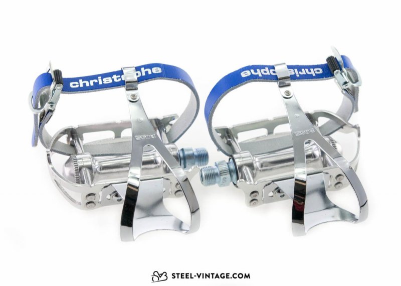

I thought we were gonna be discussing these:
