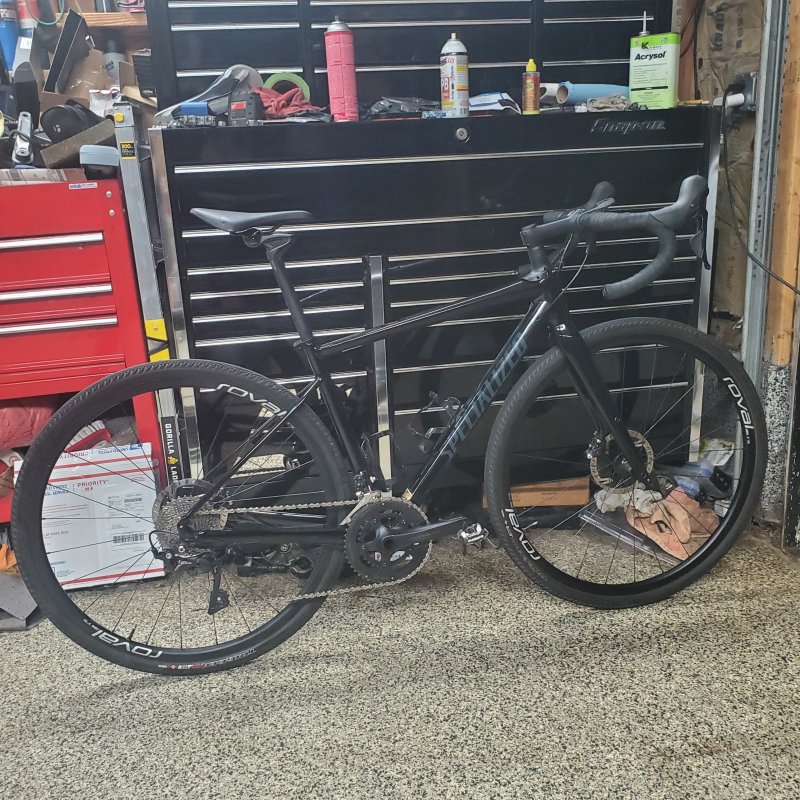

This flat issue was a problem I just went through. I stopped riding road 3yrs ago bc I couldn't deal with flats every 2 rides. I just picked it back up and got a flat on the second ride. The next day I was on Facebook looking at gravel bikes. And here we are with a 2020 diverge e5, just did 51mi, 50/50 road and gravel at 34psi and no flats and it feels like I'm riding a piece of living room furniture down the road. Couldn't be happier, wish I did it sooner.
