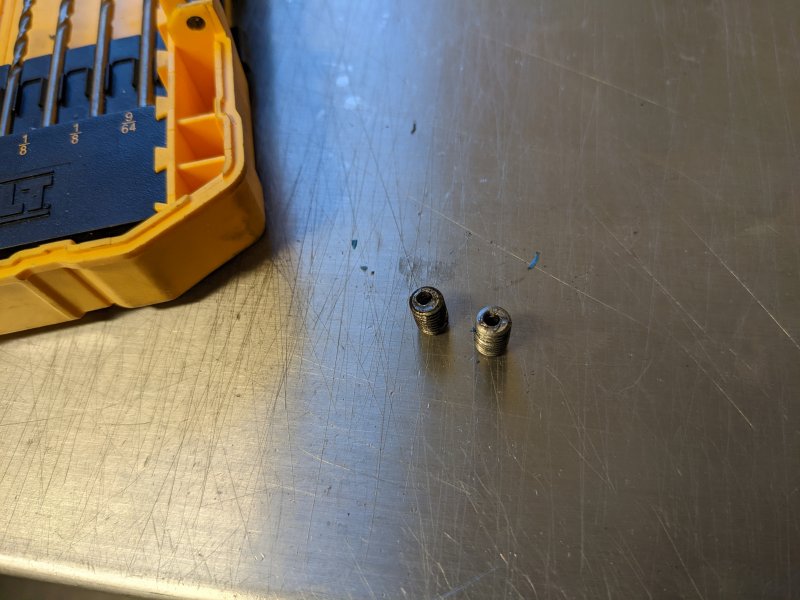

Stripped Pivot Bolt Head (on a Pivot)
Yes!!!! Used a stepped bit to get rid of the head, then the sharpened flat head in the impact driver. I nicked the rocker arm trying to shock the bolt with a small punch, applying force tangentially to try to get it to back out.
