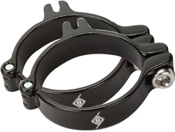

Just remembered one more...
If you are planning to go with a modern FD, check your seat tube... may not have a cable stop. Those old FD had them built in so you may need this too.

Once you take out the BB and the shell seems somewhat big... yeah... You need it to fit a modern crank.
