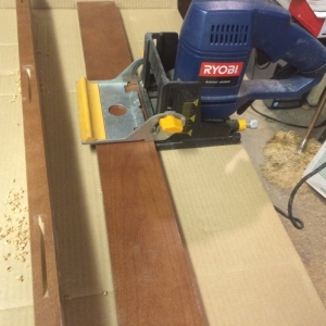

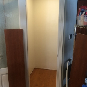

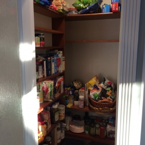

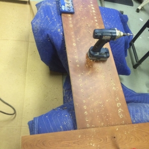

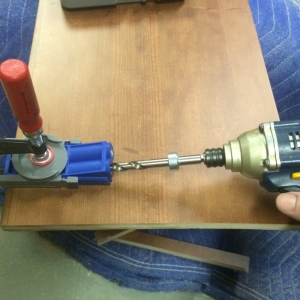

The Pantry
The kitchen project is coming to a close, and after a few tweaks, there was some cherry left - the 12" is veneered plywood, the rest is solid.
Decided on shelf pins - so set up the jig and drilled some holes. Came up short with 6" wood, so did some simple joinery - 3" using biscuits and glue.
Where the connections could be hidden, pulled out the pocket jig - used some of the trim pieces too. Still short one 12" piece, but i'll find it. (if i don't, i'll
be joining 4 individual 3" pieces. pantry is about 40"x38, with an angled edge.
Looks good, and great use of scraps. I like the "coming to a close" stage but sometimes that final punch list takes as long as the main project.
