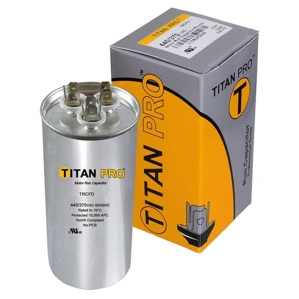

Back on capacitors, I want to order a backup. The york replacement is $50
Is there any reason this $20 Home Depot option wont do?
York:
Home Depot
Im no expert, but for the extra $30 I like the peace of mind that it's "like for like" instead of finding out on a sunday at 5pm when its been 95F all day that its not.
