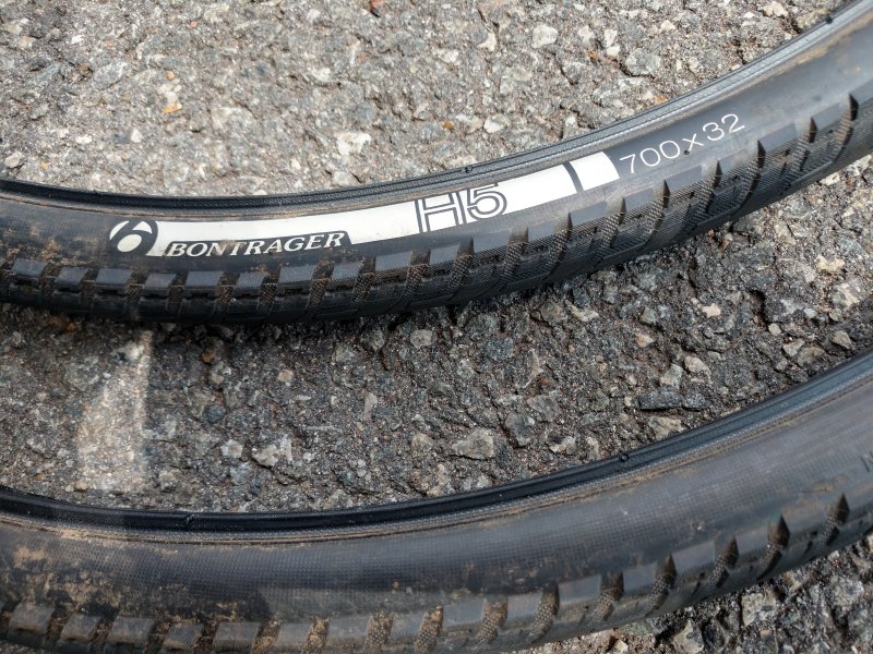

Did tubeless conversion on my gravel bike and put on wider and knobbier tires. On that note, I have a pair of OEM Bontrager H5 700cx32 tires free to anyone who wants them.
