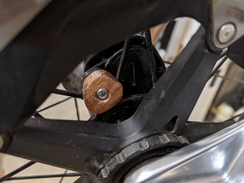

Speed sensor broke--thread insert pulled apart from the housing, probably because of the Buttermilk Valley downhill overlooking the river (so I know where to go to test my work)--so I took the opportunity to change the mounting bracket for a different style; problem: it was designed for spokes laced in the opposite direction of how the ones on this wheel are laced. Solution: crafty me cuts off piece of rubber mount where spoke needs to sit, and glues it on other side. New problem: other half of the clamshell is hard plastic, and not as easy to simply modify without pins/reinforcement. Solution: I had an offcut of walnut that was about the right thickness to copy the piece, so I got to work.
Final product took ~60 minutes of working time from modification-to-install, and I got to use my safe-edge file to do the major profiling, since I didn't want to cut into the 'core' of the piece, and the walnut was hard enough to work well with the file. After finishing/checking the fit, I paste waxed the hell out of it to give it a chance at surviving, then installed it.
View attachment 160164View attachment 160165View attachment 160166
I even managed to have the presence of mind to cut it so the grain wasn't unsupported over the spokes. Go me.
I'm getting a lot of mileage out of this piece of walnut, though it never got used for the original purpose (to be a bridge support on a zither).
Stupid question, couldn’t just mount the sensor on the opposite side of the wheel ?
Yeah, but it doesn't fit next to the rotor, and I don't trust it on the other side where it would get whacked with brush...especially since the mounting point seems to be the weak area.
That’s why I like the Garmin sensor as it sits on the hub, I added some double adhesive tape on the bottom to make sure it doesn’t fly away if the rubber band brakes.
I personally dislike the rubber band mount. I think is it functional, but aesthetically crude. While I appreciate function when it works well, if there is an alternate option that doesn't look like someone stuck a wart on a [really] expensive hub, I'm going to take it.
I'm outside the use case of the Cannondale version of the sensor, so I can't blame it for not working 100%. Never have a problem with them on any of the bikes they come on.

My made piece held up fine, unfortunately my modified rubber bit didn't; I decided, in my haste, to make a series of cascading bad choices: I prepped the rubber surfaces poorly; I used the wrong adhesive; I didn't test the bond before installing it. It rocketed off the spokes on a rooty descent, and I was lucky to recover the unit.
Take two, coming up.
Take two:
As it surprises absolutely nobody, looking up proper adhesives for what you are bonding is better than "YOLO, whatever". It turns out that EPDM rubber (which is something like 99% of what they make shims/etc on nice bike things out of) has two adhesives of choice: a really stupendously expensive specialty product, and well-prepped cyanoacrylate...aka: superglue.
I roughed the surfaces using 80grit paper--stuff they include in patch kits--swiped them with acetone to remove any mold release compound that might still be present, then followed with alcohol, as recommended for bonding EPDM. They warned that you had literal seconds to position your piece, and they weren't joking. Within the space of 2-3 seconds, it was firmly attached to the bonding site. I let it cure for 30 minutes, then installed it and allowed it to finish curing under pressure, monitoring it for creep. It didn't move, and checking it after riding, it was still firmly attached to the site.
Pictures look identical to the first, but it didn't shoot off after riding for 45 minutes. 🙂

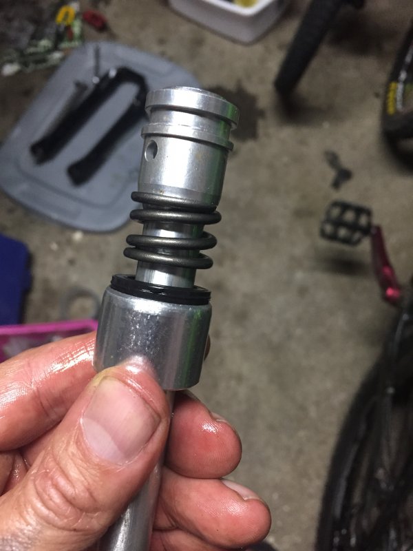

Opened up the Marzocchi DJ1 on a new (to me) GT Labomba I bought. Tried to get rid of the top out clunking these are known for with a rubber washer between the topout spring and the piston. Partially successful. Dulled the clunk but didn’t eliminate it.
